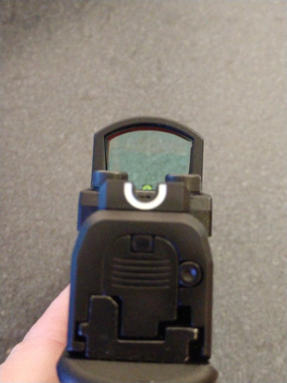

Here are 2 pics I took, the first showing to fully see the "ball" of the front sight, it is too high or above being centered into the "U" or the rear sight.
The 2nd photo shows where I would estimate the front sight should be within the "U" of the rear sight ...but can now only see about half of the front sight. Seems imperfect to me ... as I probably would need to only see the top third of the front sight to really have it centered perfectly in the rear sight.
I've not zeroed or shot with the optic yet, and that is the main goal ...so I suppose the co-witness issue could just be a minor "adjustment" in sighting I'd have to learn to account for should the optic fail .... but still ... supposedly the RomeoZero was advertised as allowing co-witness on the Hellcat and overall I am disappointed.
For that reason and the run-around with the screws not fitting etc ... I would have expected my LGS to let me return the optic ...
Anyhow ... who all has really acheived a 100% co-witness and who hasn't?

I was led to believe that the RomeoZero would allow 100% view of the front sight as well, to allow a true co-witness.
I'm assuming those others that post saying they can co-witness, are saying that because they at least see part of the front sight ... unless for some reason some of the RZ sights do allow co-witness and some don't (meaning that is a wide variation in how each unit is built).

I think we have different understanding or definition of "co-witness" ... I'm relatively new to handguns (always had a rifle all my life, but have had my Hellcat just a few months) ... so I'm probably using the term incorrectly ... but what I'm talking about is being able to see the entire front sight post and the rear U-notch sight in case the RMR ever fails.
That was my understanding of co-witness ...that should the Red dot Sight ever fail and you don't see the red dot to use for aiming ....that as a backup you could still be able to see through the lens and see the iron sights and use them as you normally would.
For me, that also means that I should be able to use the iron sights through the RMR lens "exactly" how I would use the iron sights if the RMR was not installed ....meaning I should see the entire "ball" of the front sight and should be able to "drop it into the bucket" of the rear U-notch sight.
The issue I'm describing, with the RomeoZero ...is that I cannot see the entire front iron sight ...through the lens of the RomeoZero .... that the body of the RMR blocks my view of the front sight ...that when I try to sight in or aim using the iron sights looking through the RMR lens ... I cannot drop the ball of the front sight fully into the bucket of the rear sight ...before I start losing sight of the front sight.
The Shield SMSc and RMSc optics ... I have just recently learned ... have a notch or channel in the body if their RMR's ... that allows you to see the entire front sight even when aligning it fully down into the bucket of the rear sight ...
...and this is what I was calling 100% co-witness ....
As it stands now with the RomeoZero ... should the optic fail ... I would not be able to use the iron sight to aim in the same fashion as I can if the optic was not there ....
I can't fully align the front sight down into the reau U notch ... I start losnig sight if it ...and that is why I commented that I would have to "estimate" my point of aim if I had to co-witness.

Go back and look at the 2 images I posted ... in the first, to fully see the "ball" of the front sight, if I had to use the iron sights ... you can see the front post is way to high and not in the bucket and all my shots would be high.
When I try to lower center the "ball" of the front sight down into the U-notch bucket (as is how one should use these particular iron sights), before I'm able to do that I start losing sight of the ball because of the body of the RMR (the 2nd image I posted).

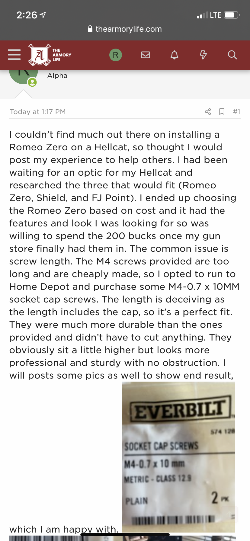

Took a pic of my post, hopefully this helps. Had the same issue. View attachment 7826
This is the post, or information I used to go buy the same types of hex-head screws to use in place of the ones that came with the RomeoZero.
After a couple months of the run-around from the LGS where I bought the optic, and refusing to give me a refund and sayying I would have to leave my Hellcat with them a couple of months if I wanted their gunsmith to mill down the screws and mount it ... I finally decided to go to Home Depot and pick these up and try them out.
As advertised, they seem to fit perfectly.
I also had a hard time finding a measuring tape or measuring stick etc ... that had a metric scale on them ... and my eyes aren't good enough to distinguish 0.095" on a tape measure.
That was yet another setback or delay for me ... actually had the hex-head screws a few weeks ... then one day walking around in Walmart ... I pass by the aisle with the sewing needles, thread, etc .. and there it was ... for $1.47 a tiny measuring stick wtih a metric scale and even a "slider" to allow me to make precise measurements. It is called a "sewing and knitting guage", you will see a partial image of it in the 2 photo's I'll attach.
