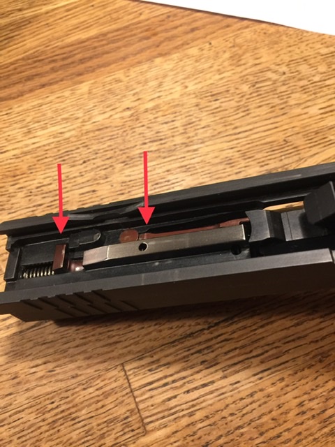

The topic had me check on this, so for some reference and comment, here’s my XD45 (circa 2008) showing rust…or discoloration? Obviously this are not plated parts and actually received a film coat of oil over the course of years of cleaning. These are the only 2 parts that that show rust. Magnified, I don’t see any pitting or flaking corrosion and more importantly no malfunctioning.

almost looks like discoloration. but i cannot see up close, like you can.

That’s what I think, but there is a bit of wear showing the shiny metal under.
I won’t be putting any abrasives to clean this but the coating or discoloration is odd and not like a true rust oxidation like with ordinary steels.

Thats not rust, thats the color of those two parts.

Some alloys turn a plum color when blued. Here's another explanation: "The plum color is caused by the metal composition and temper plus the strength of the bluing bath used. The weaker the chemicals, the thinner the finish and more likely the color will turn purple. The bluing bath can also be at the wrong temperature."
