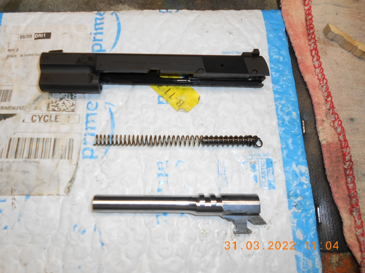

took it home, stripped it, cleaned it, and lubed it.

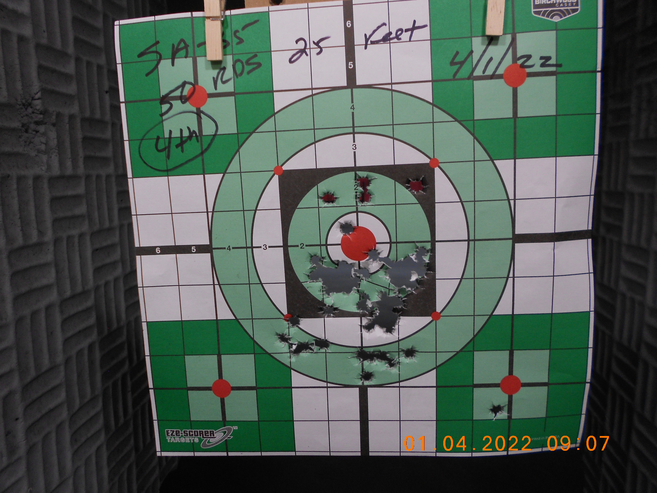

ok, i took the SA-35 to the club this morning, and 200 rds of 115 gr, Magtech ammo.
NOT.ONE.HICCUP.
the 35 ran like it was on fire.
i just need to get better at shooting it.
this is the "better" target of 4 in total, @ 50 rds per target.

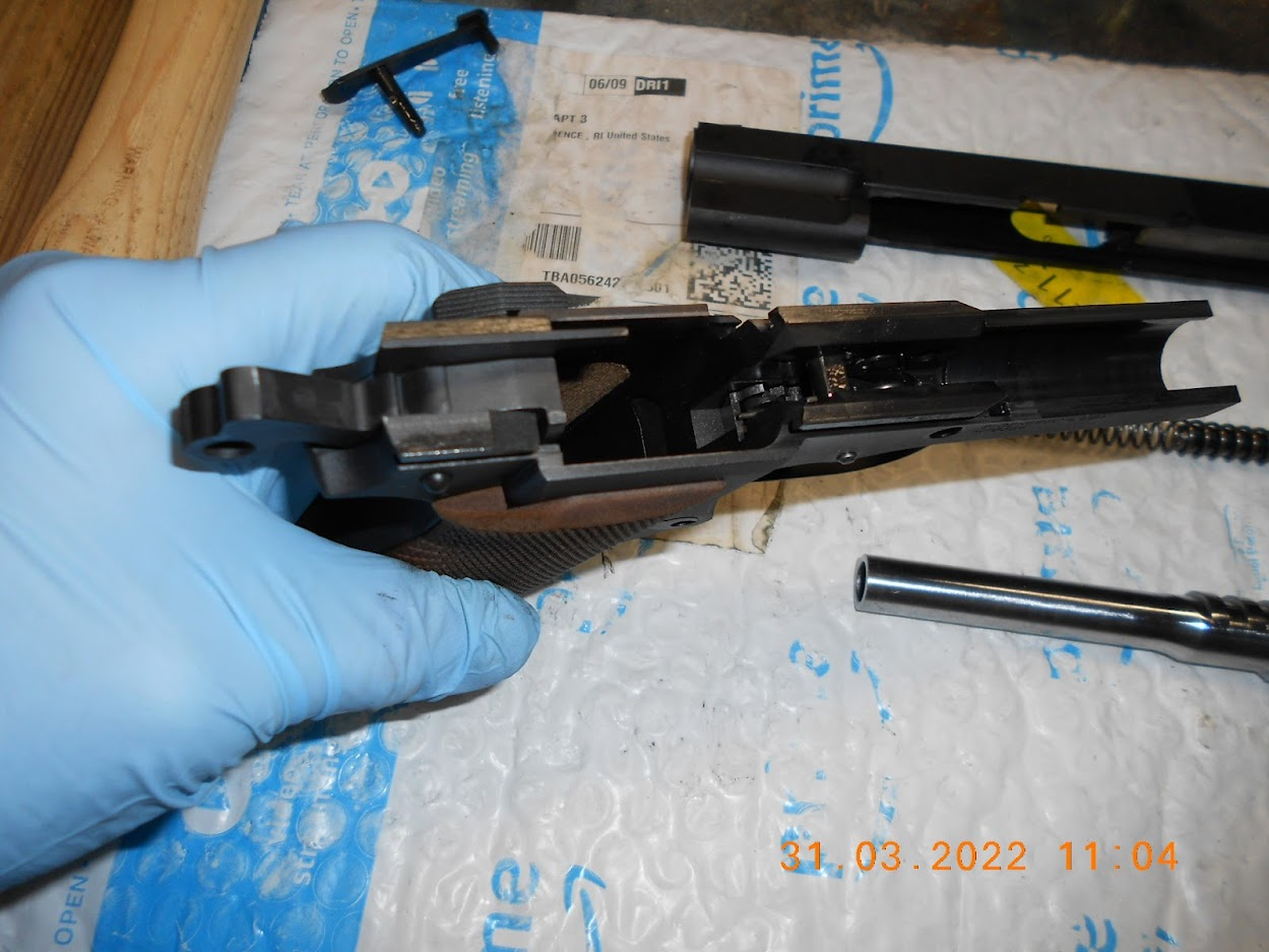

took it home, cleaned and oiled it again. what i failed to do the other day when i first field stripped it?
i did not put a drop of oil into the tiny ball bearing in the guide rod boss. (for the lack of the real name)

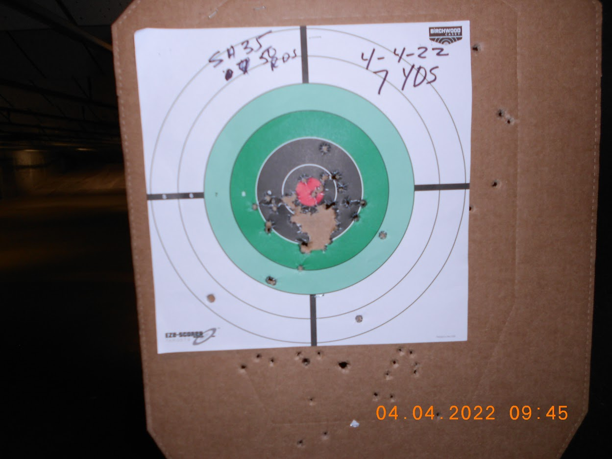

took the SA 35 to the range this morning, put another 100 rds thru it. (300 thus far) this time S&B 115 gr,
still gotta get to know the sights better. a couple of low hits, but not one hiccup.

If I may, I think your low shots is all about your grip &/or trigger finger during the shot as opposed to the sights.
Your 90%+ below bullseye grouping leads me to believe its your Grip , possibly your sight plane… my .02 cents

yeah, to me it's just a different "feel" to the grips over say my 1911's. can't really explain how i mean to say that.
