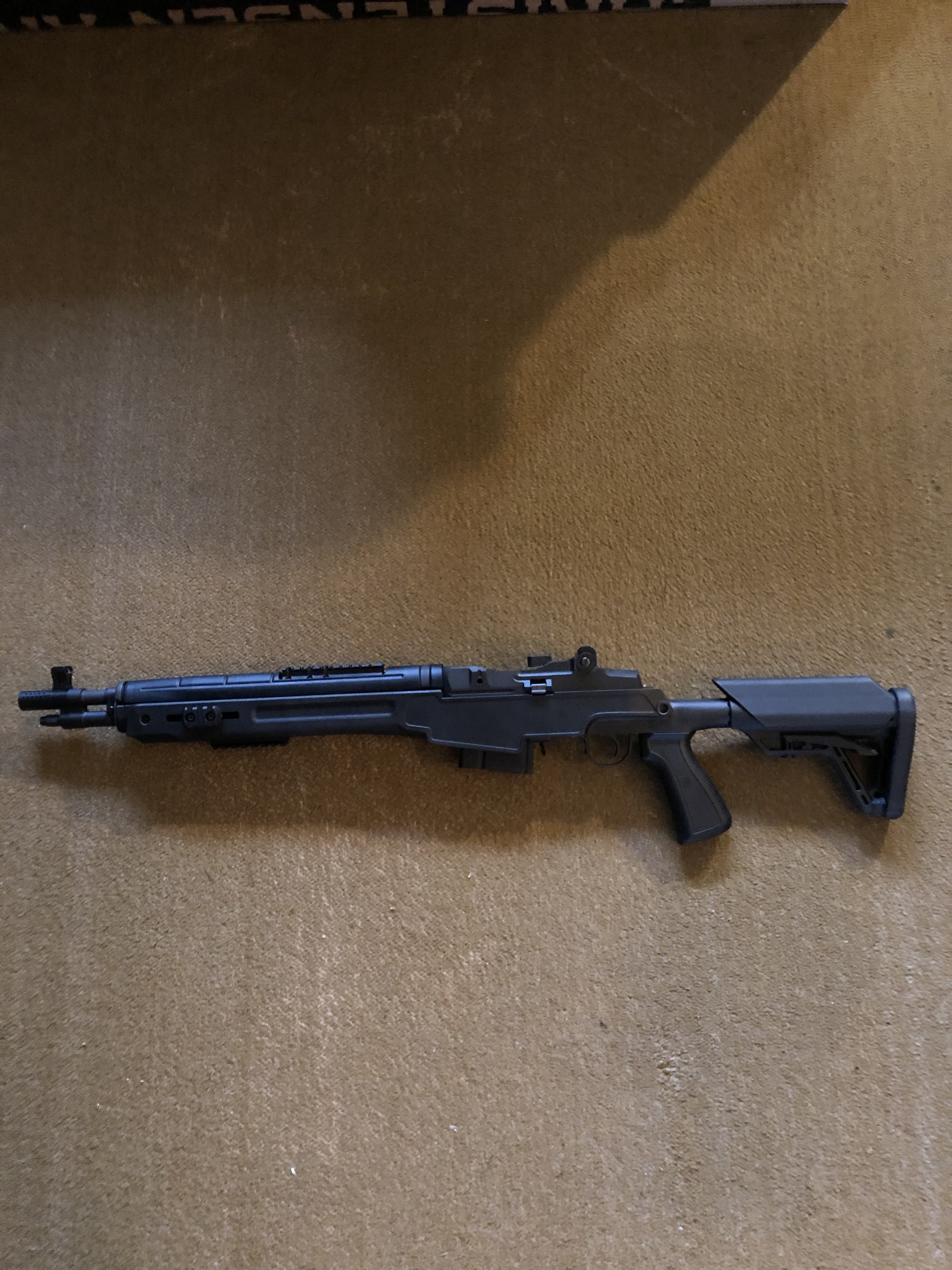

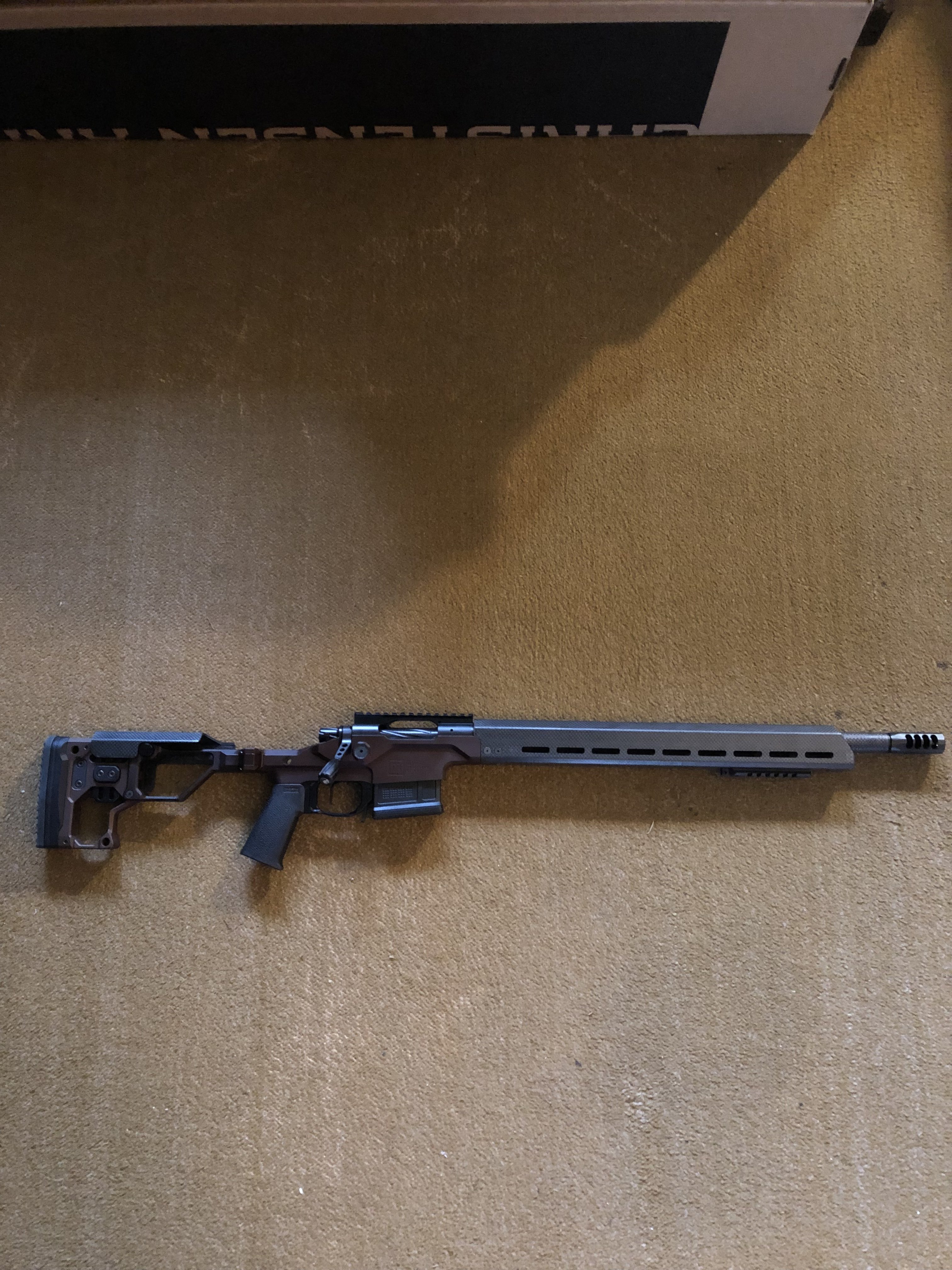

Well, to be fair, it was more like the last two weeks or so (and to others, sorry about the temporary highjacking of this thread, but Bob insisted 😆):
Pic 1: Sig Rattler Canebrake 300 BLK; Pic 2: Christensen Arms Modern Precision Rifle 20” 308; Pic 3: SA M1a SOCOM 308 w/ Archangel collapsible stock; Pic 4: (top) Stribog SP9a1 K w/Sig MSR optic; (below left) S&W M&P 2.0 45 Compact; (below right) H&K HK45 45ACP
