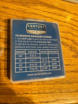

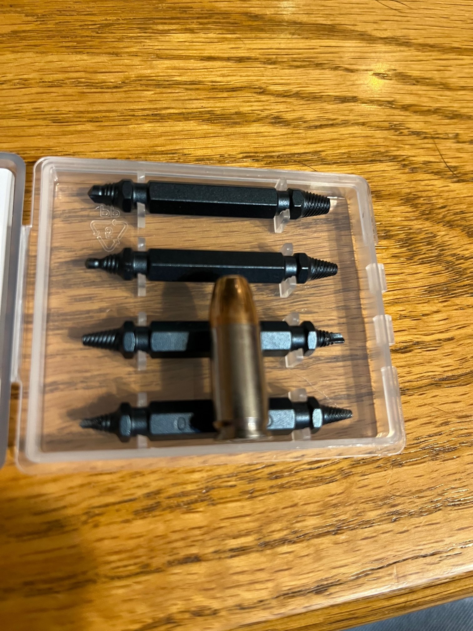

These are the smallest extractors I could find. That's a 9mm if you couldn't tell...
They have worked on screws in AR riser mounts. Not that I ever needed to use them on previously Loc-Tite'd and then stripped screws or anything....
