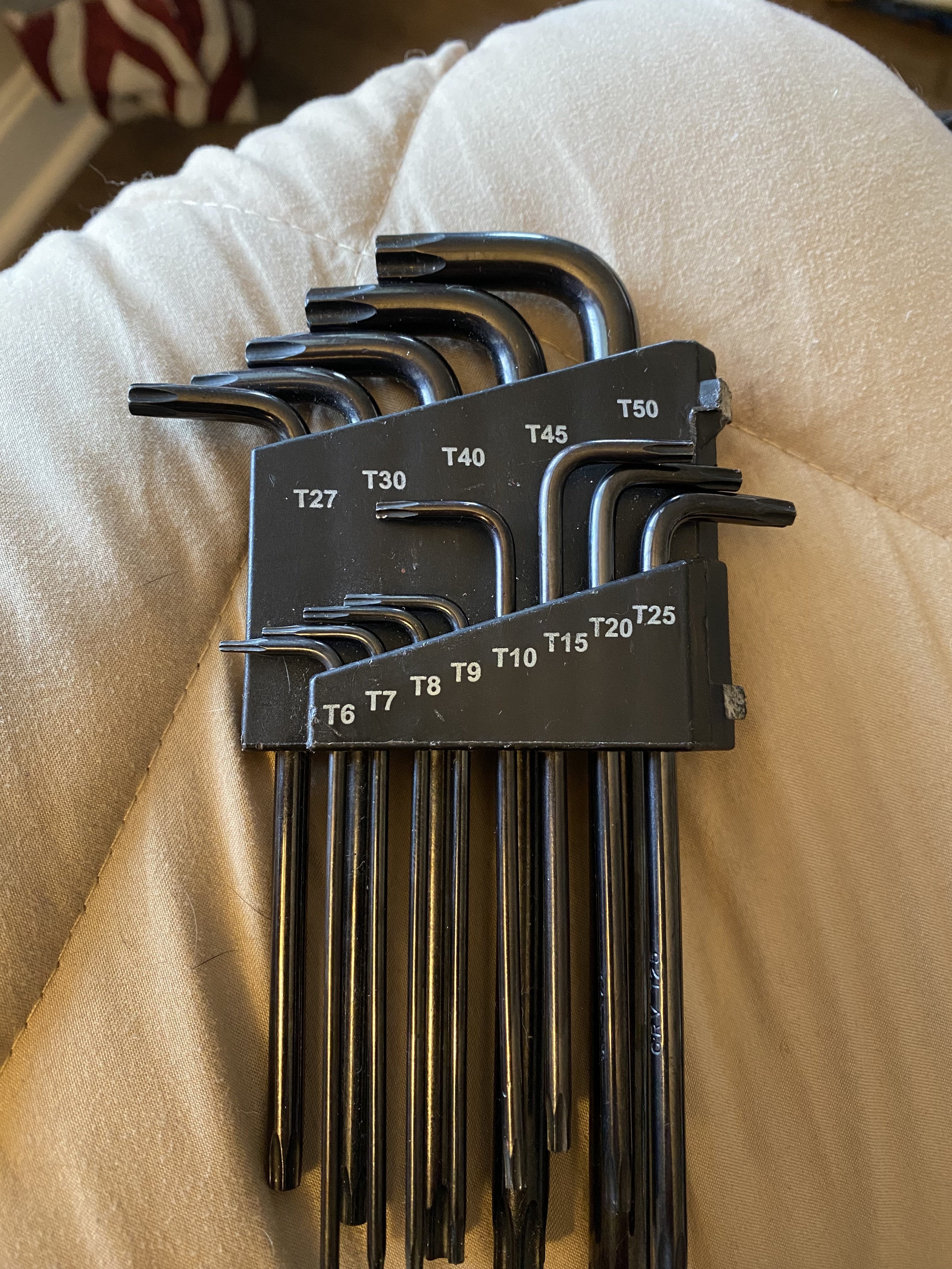

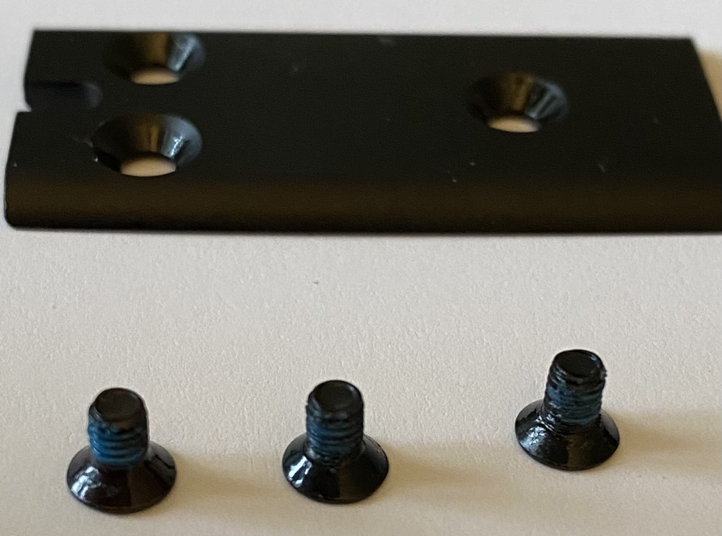

So I picked up my Elite Compact 45 and had no issues removing the 3 screws and plate, each of the screws had a dot of blue Loc-Tite on the threads.
I used the T-10 in a kit I have.
They were snug but not overly tight.

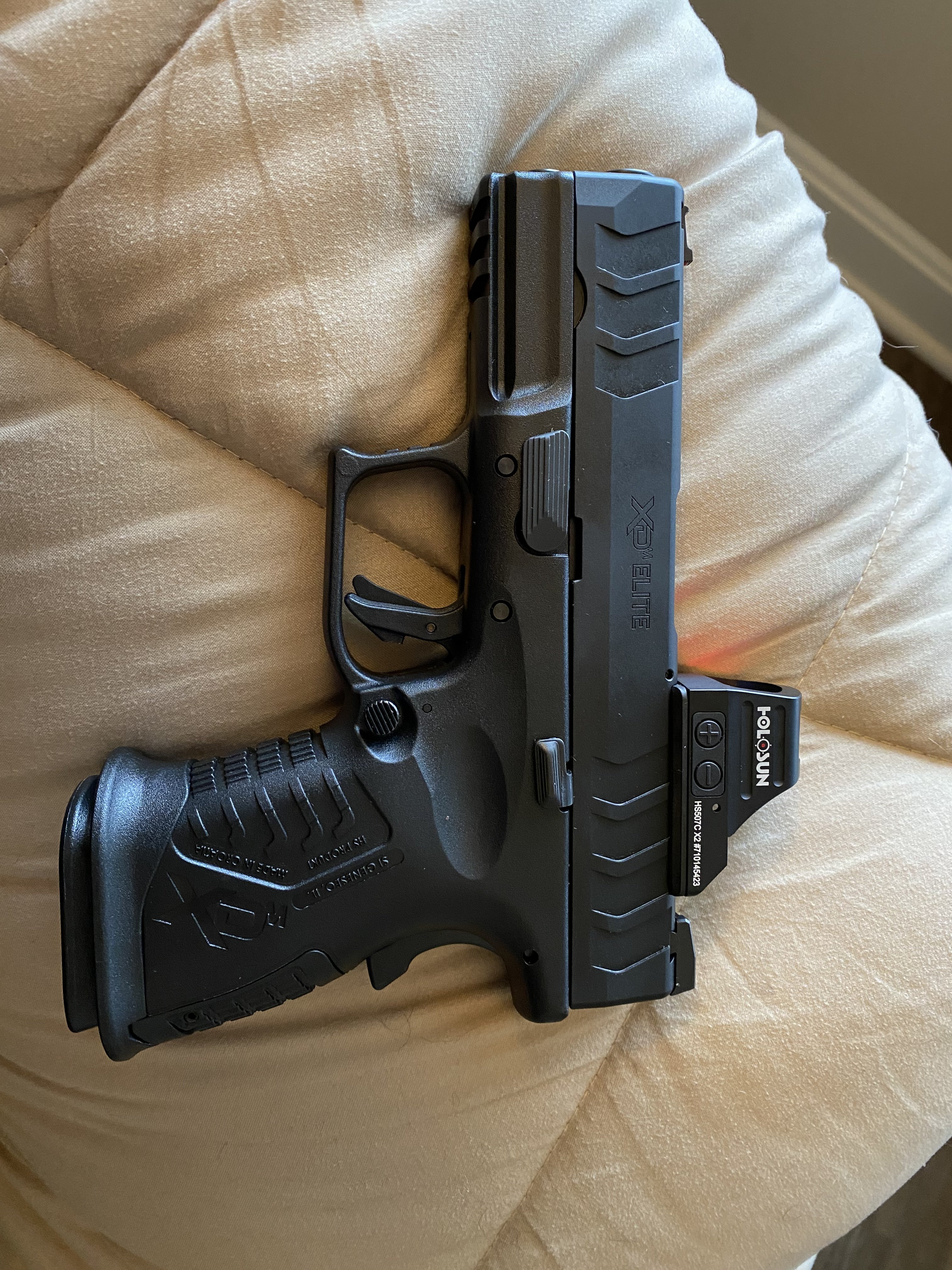

As an update I’m installing the same Holosun on my new Elite that I have on my 10mm Elite, the 3 screws that held on the guns cover plate were used to install the red dot mounting plate, the Holosun came with two different lengths of screws to mount the RD to the mounting plate, two of one set worked perfectly.
Each screw had Blue Loc-Tite on the threads.
Install complete 20 minutes.

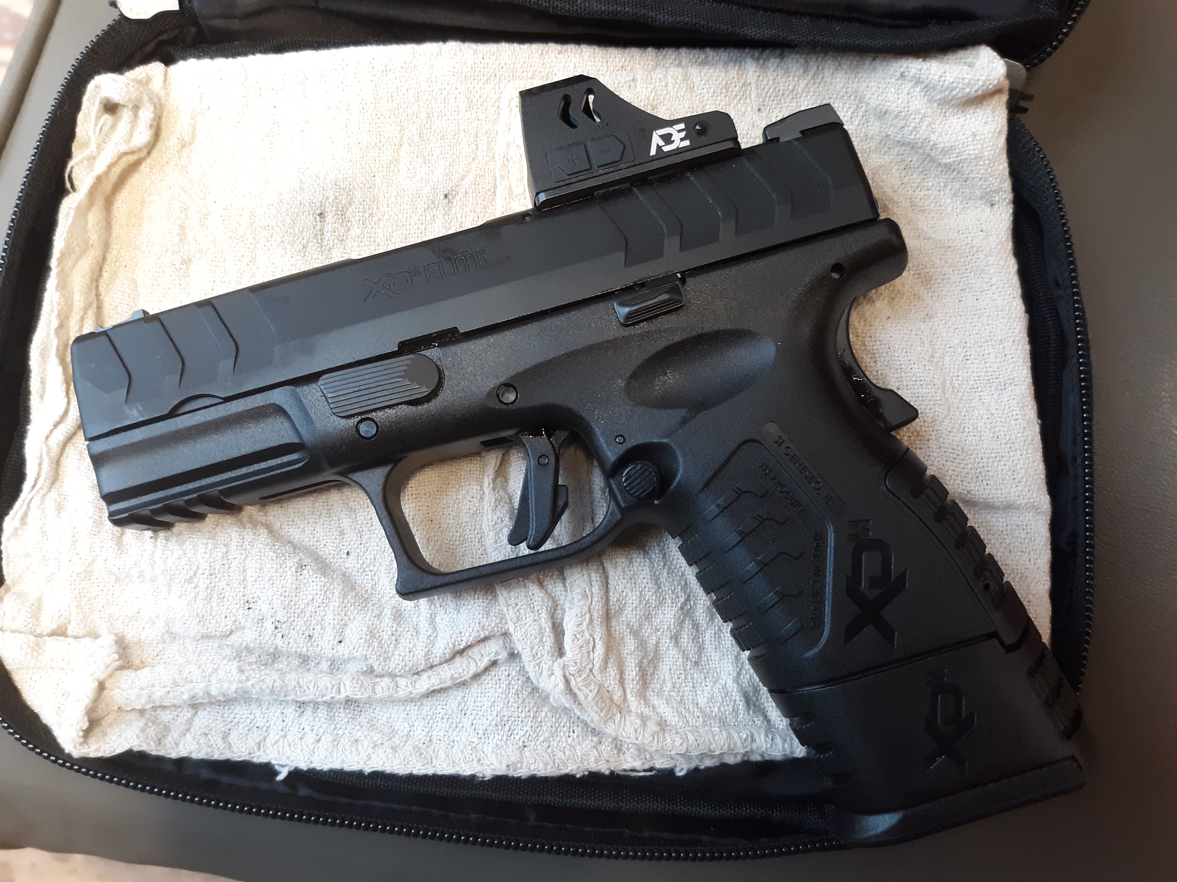

I got a XD-M Elite OSP 4.5" 9mm new, it was 20 minutes to pull the cover plate and install the adapter and RDS.
