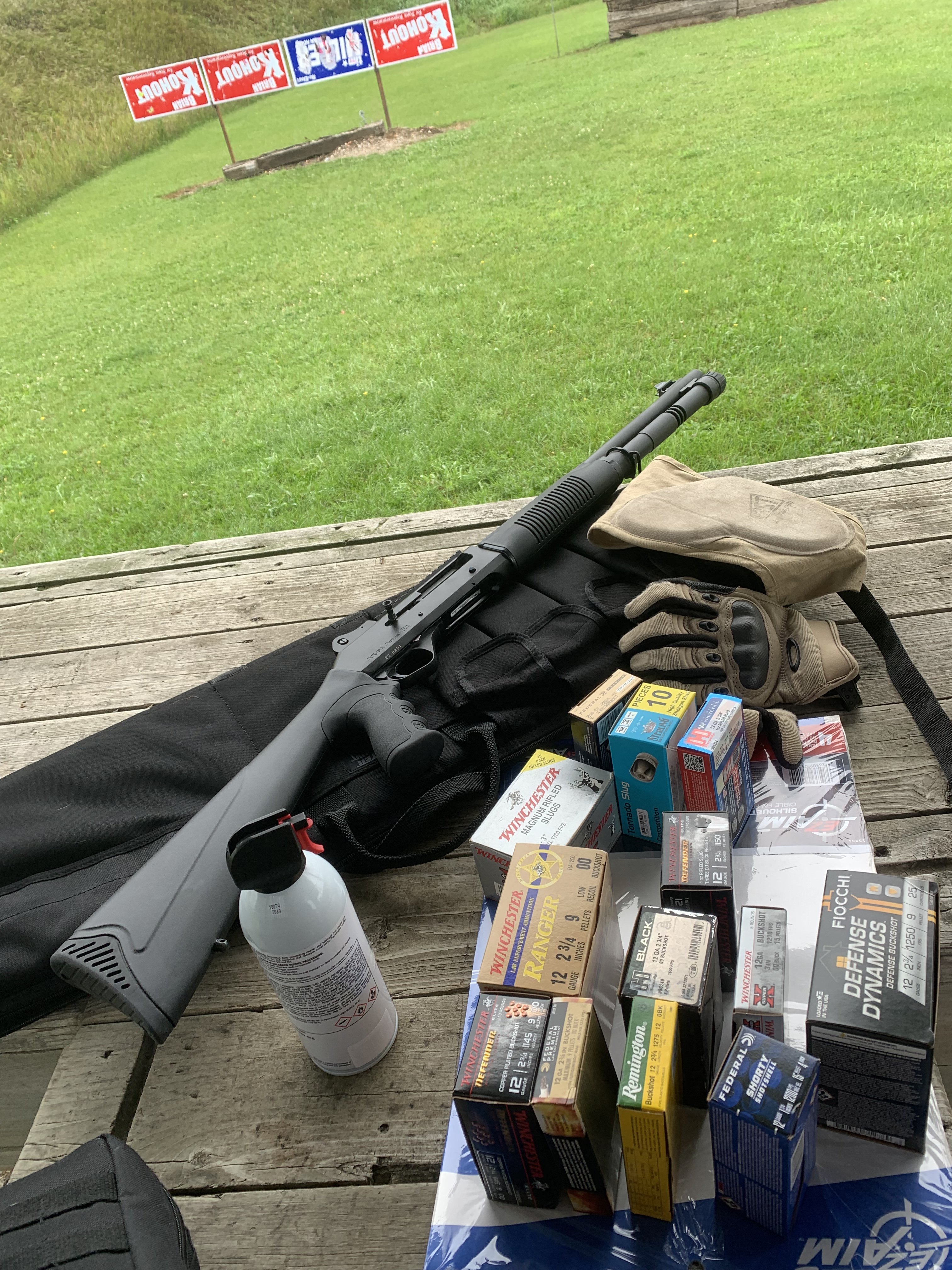

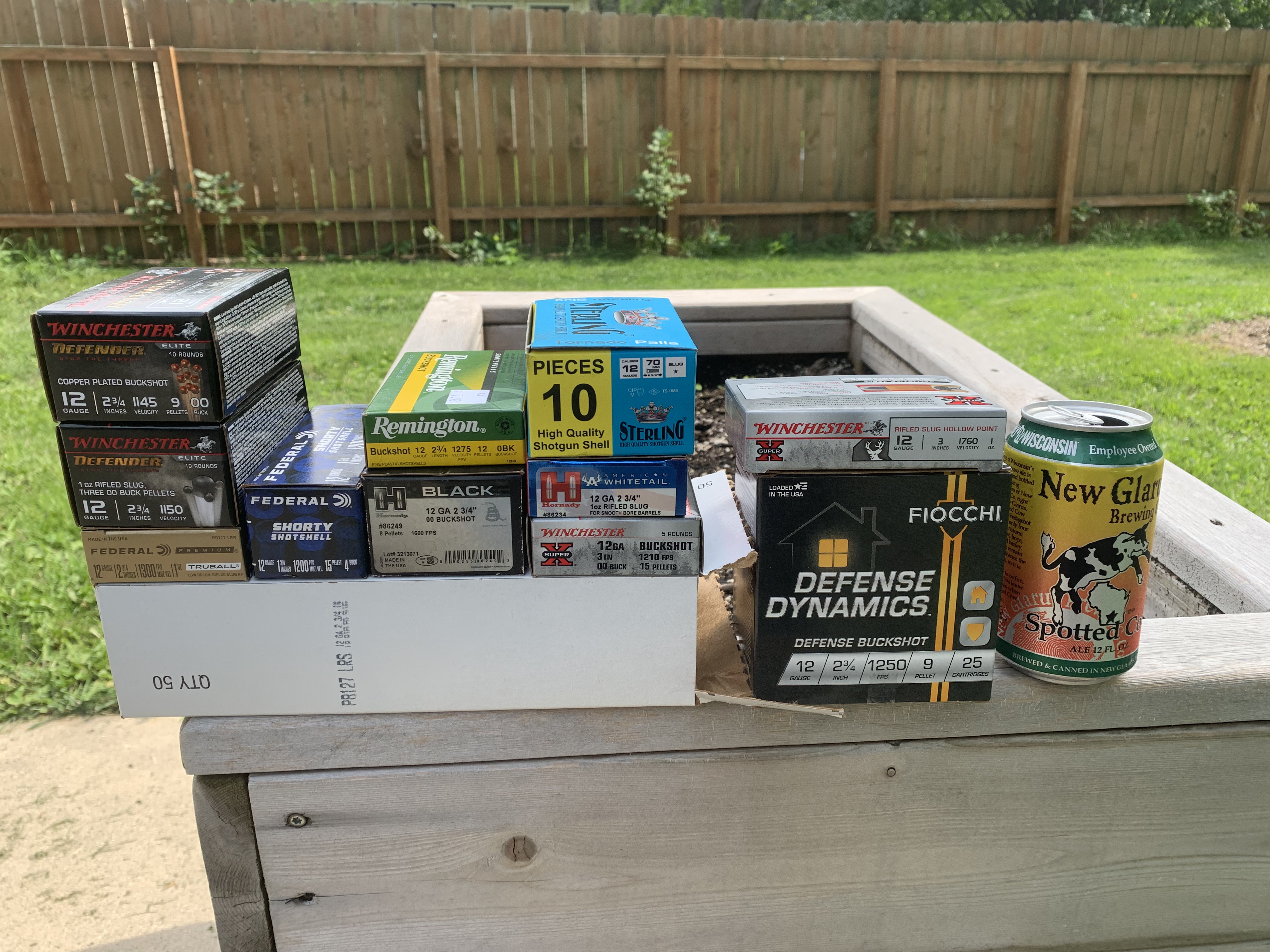

Here’s a sample of what I’ve got to put through it tomorrow…
And a little to go through me today.;)

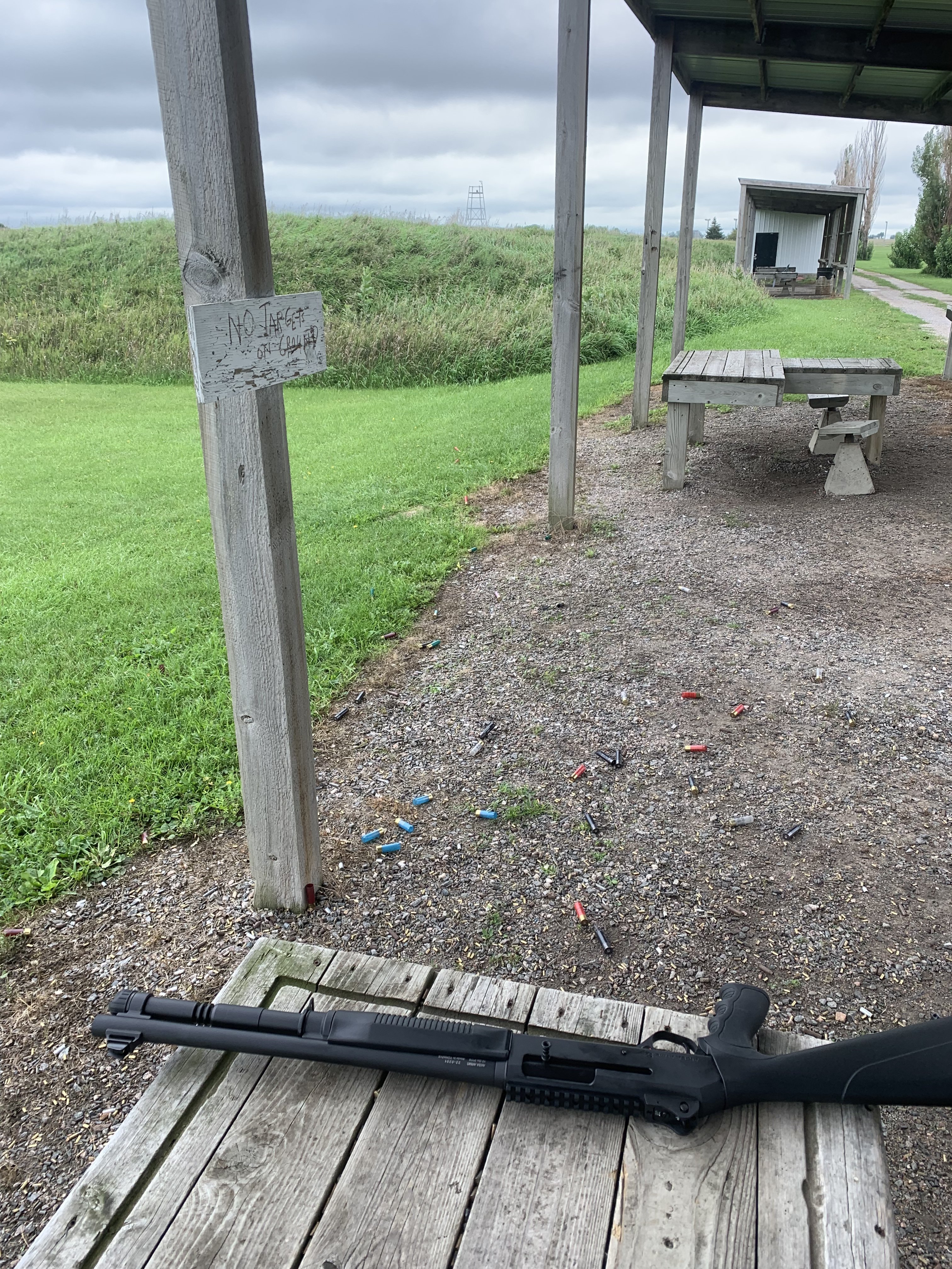

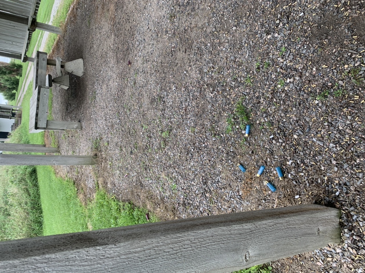

Next, the Fiocchi 00; 9 pellet, 1250 fps. No loading issues, and they ran fine as well, although definitely did not eject as aggressively as the Federal…View attachment 30155
Blue hills: Fiocchi, red hulls: Federal

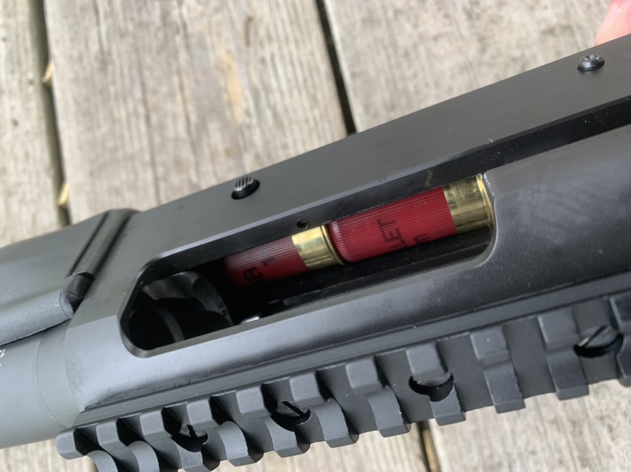

And, some goofing around…Federal Mini #4 buck. No way this runs, and I was MOSTLY right. Loaded one round in the spout, and two more in the tube, and…failure, as expected.View attachment 30156

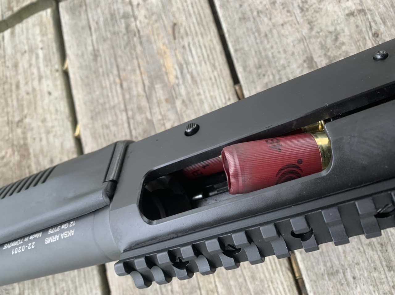

Failed to eject, and two rounds jammed on the lifter.View attachment 30157
I was able to force the forward shell back into the magazine and get it to feed the round, fired again, expecting another FTE…but, nope. It ejected, and fed the round in the tube. Tried it again, put one mini in the chamber, dropped the bolt, put one mini in the mag…it ejected the first round, fed the second (but didn’t eject the second round). I was more than just a little surprised.
