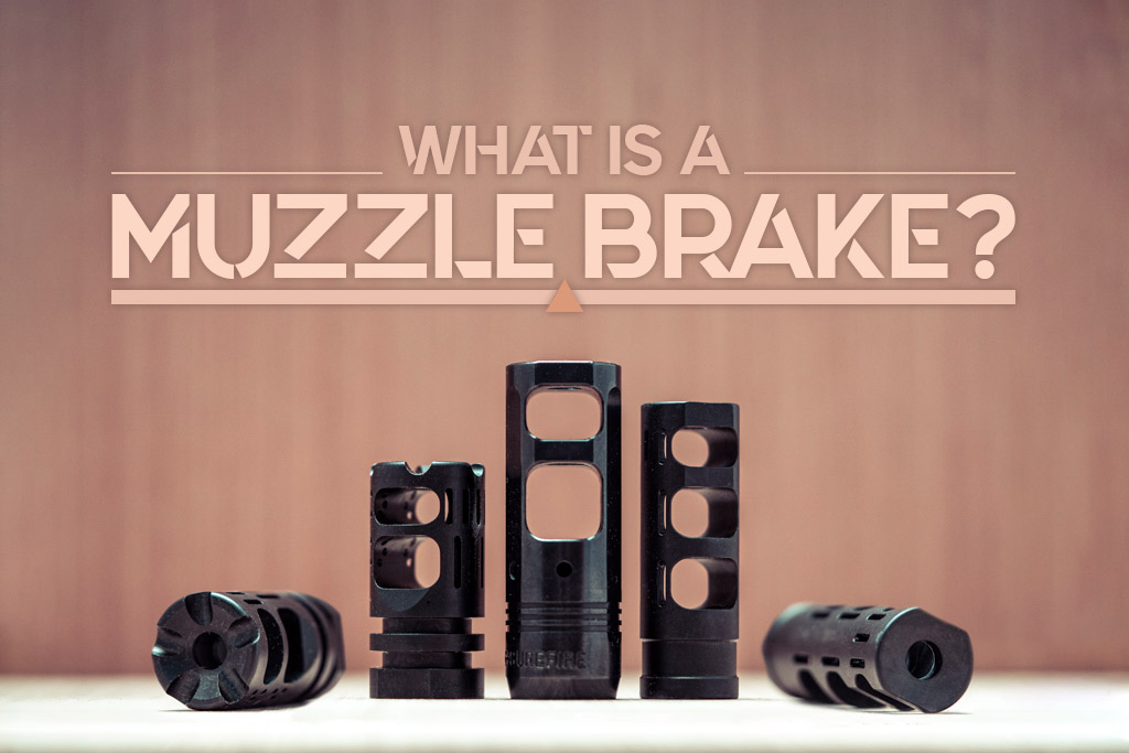

What Is a Muzzle Brake
While there are many different types of muzzle devices on the market, one of the most commonly used is known as a muzzle brake.
