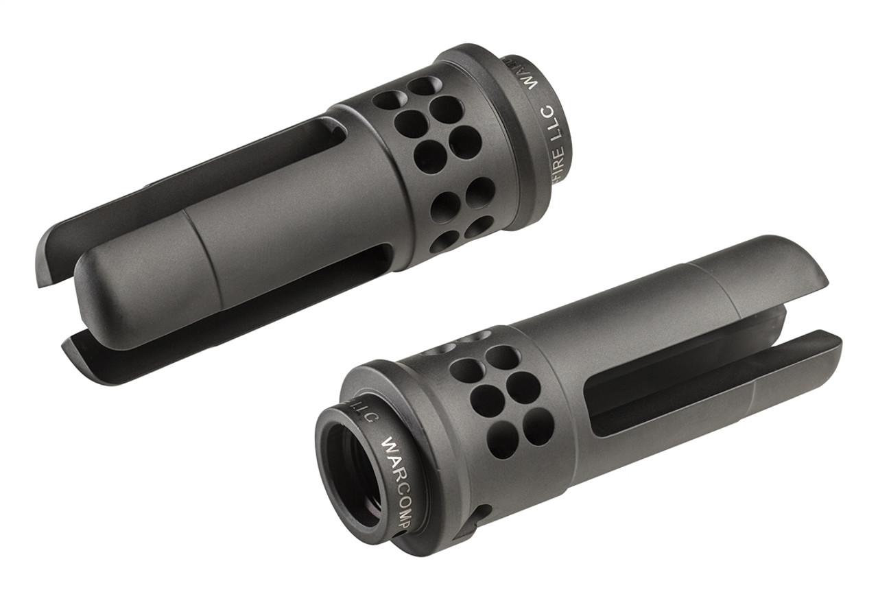

My all time favorite muzzle device for the 5.56 platform is the SureFire Warcomp. It just does everything so well! Class-leading flash suppression, recoil reducing brake, and the added bonus of being a suppressor mount... Who could ask for more?
