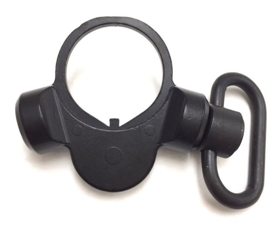

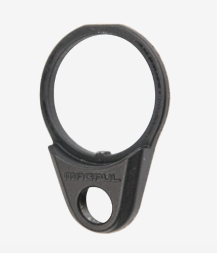

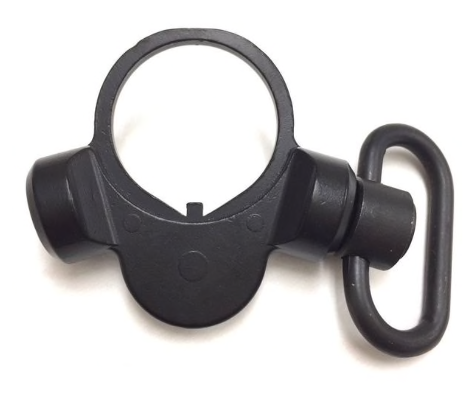

Is there any benefit between the 2 endplates pictured? When the gun is hanging with a single point sling, would it be better that the QD is on the side vs the back? Screen Shot 2020-05-01 at 6.37.09 AM.pngScreen Shot 2020-05-01 at 6.31.56 AM.png
Is there any benefit between the 2 endplates pictured? When the gun is hanging with a single point sling, would it be better that the QD is on the side vs the back? View attachment 5336View attachment 5337
Yes there will be a benefit to a QD endplate vs the QD sling on the side. It is the weight and it will not be distributed evenly with the QD mount on the side. The QD mount on the stock will not allow the rifle to ride up high enough either and will beat your knees up. The QD endplate will be, in my experience and opinion the best option.
