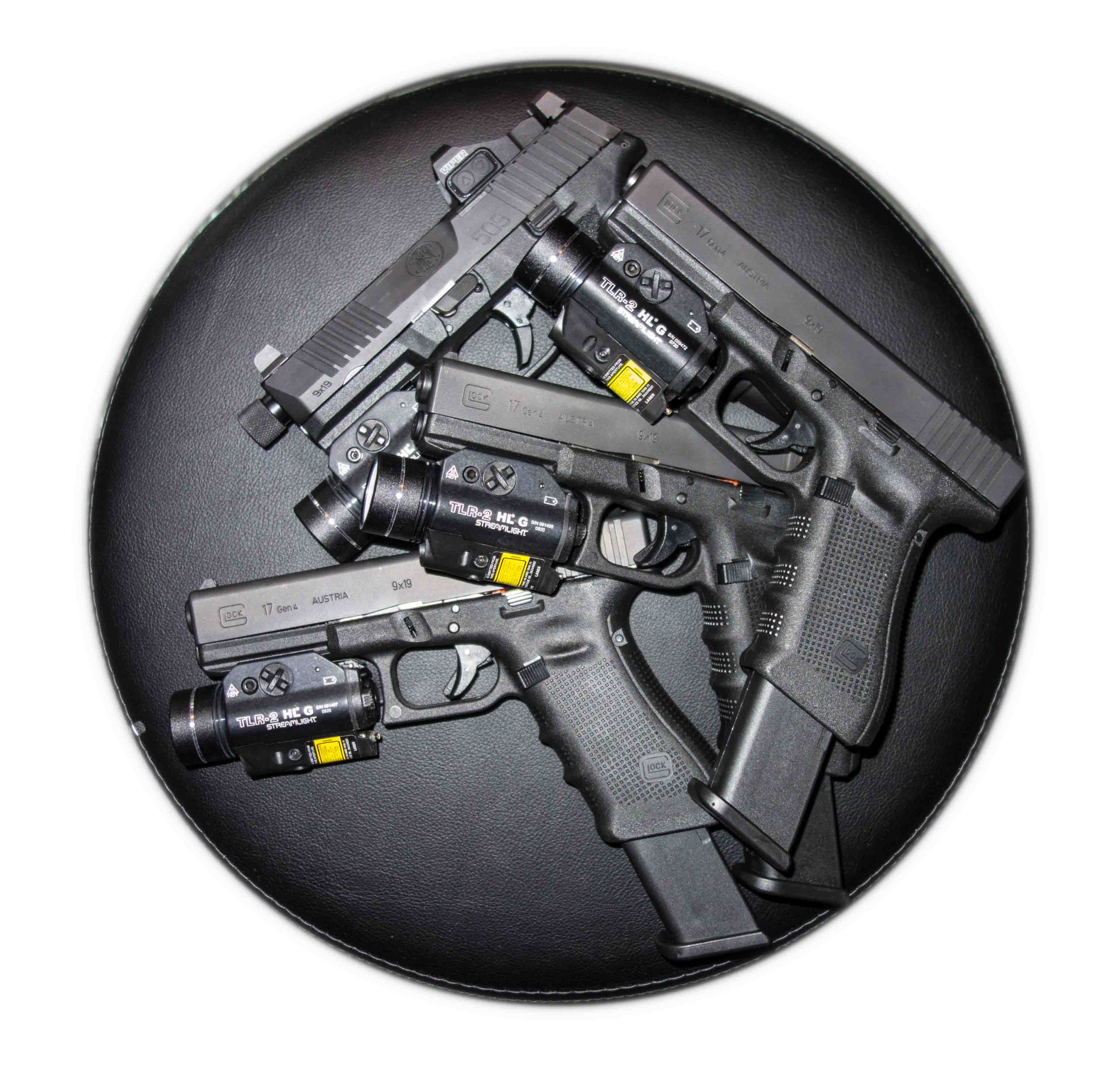

I got 2 Hellcats. No need for having none available. Buy another one OP. I'll get 2 more Hellcats later on.
I gave up on revolvers for CCW after Summer of Love 2020. Now carry 2 Hellcats. Went from 5 rounds to 30 rounds. Hellcats are the standard in micro 9mm that all the others strive to be.
I still got tons of Glocks and some FN's round the house. But only carry Hellcats for CCW other than a Glock with drum mag as a trunk gun unless I'm packing a SBR AR.
Have many backups, two is one and one is none OP.

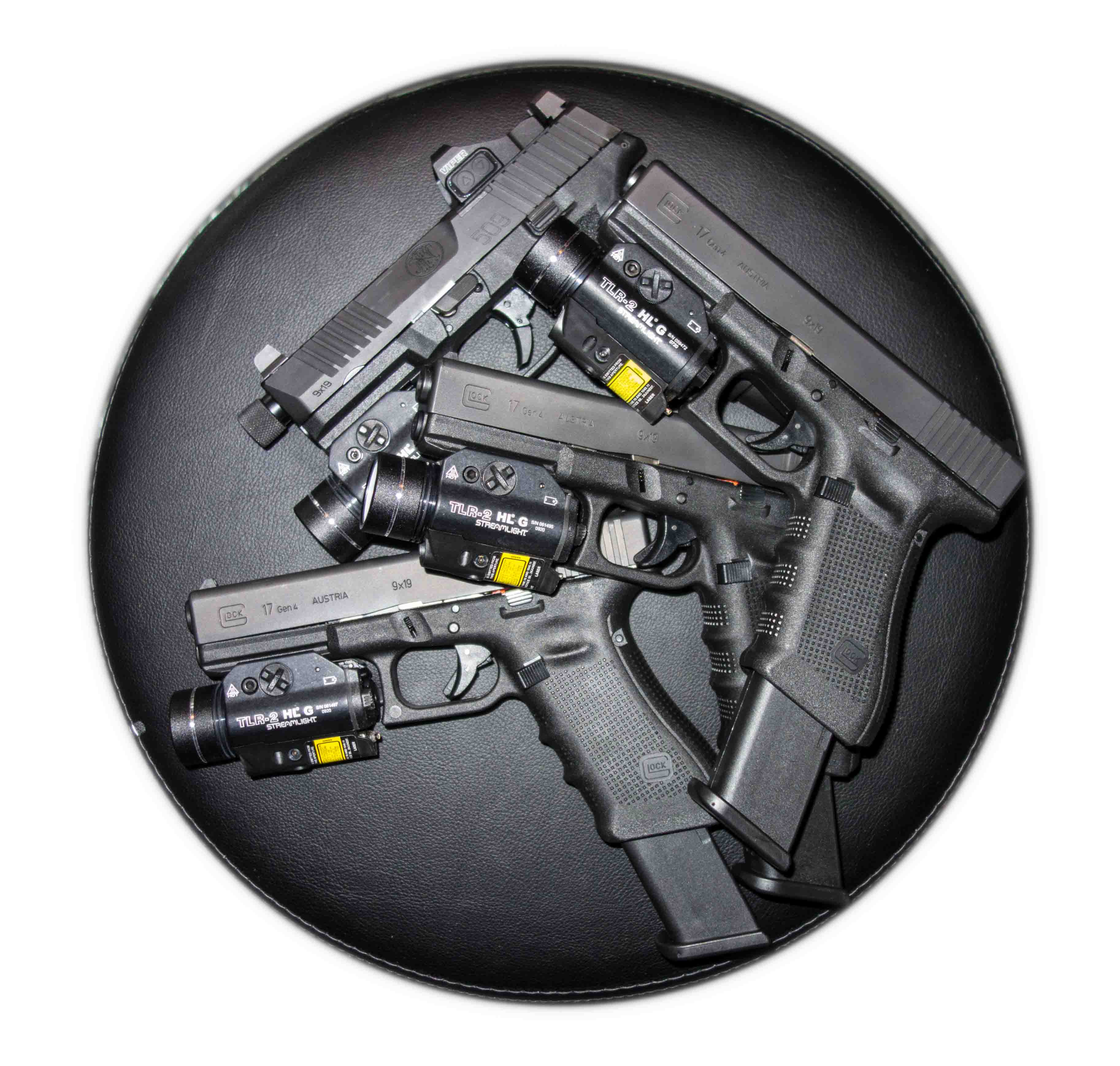

Have many backups, two is one and one is none OP.View attachment 21629
3 paperweights and a fantastic firearm. 😉😉😁
