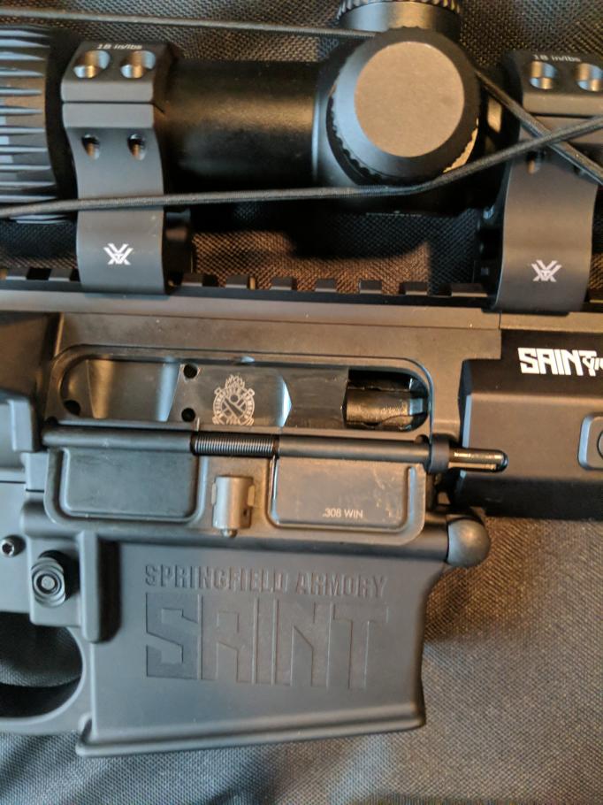

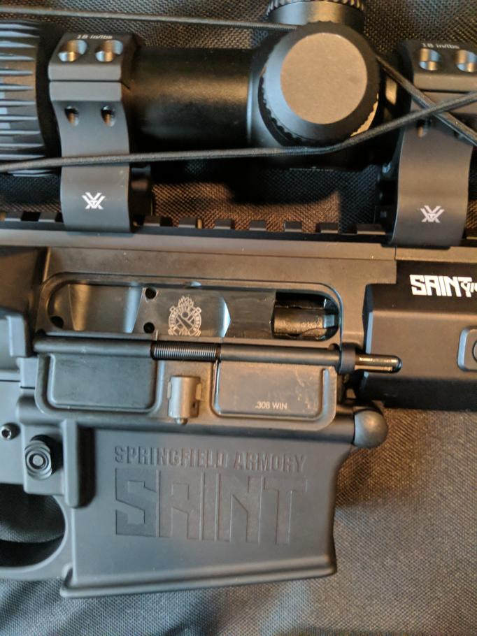

Another trip to the range and after 10 rounds the BCG seized inside the chamber, I can't pull the charging handle back at all. I've babied this rifle from the day I got it and all it's given me is problems. So frustrated with it.
Have you tried jack hammering it . Grab the forearm, hold the weapon vertical. With your other hand pull down on charging handle, then slam the butt onto the floor or other hard surface. The other option is pushing both pins out and letting the action come forward. You will have to hold your mag release button iirc. By how far the carrier is back, it looks like the bolt is completely of battery. The upper will have to come straight forward to prevent binding the bolt carrier in the buffer tube or receiver extension
I cleaned and lubed it before I took it out today. Already emailed SA so I guess i'll need to wait and see what they say.
A few of the RSO's tried freeing it with that method as well as trying to free the Charging Handle with a rubber mallet but no luck.
Appreciate the info guys.

Yes I separated the upper and lower, Still cannot get the BCG unstuck.

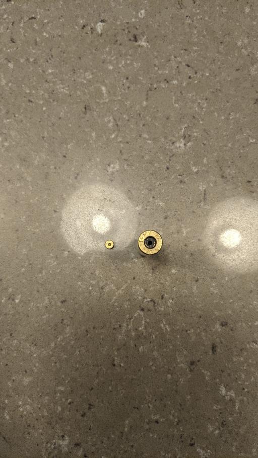

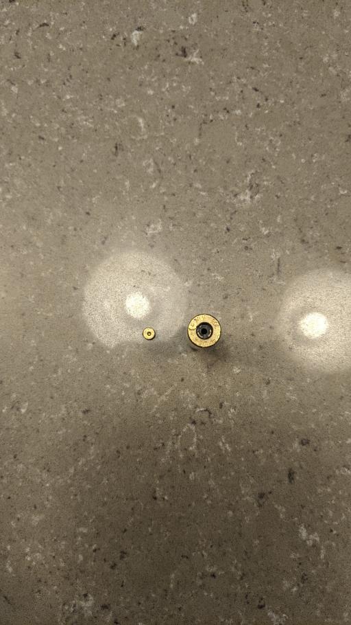

A more interesting note is this. Found this casing in my range bag which I thought was strange, and then when i Just separated the upper and lower, this little guy fell out.
Blown primer. I saw they same in my FAL KABOOM.
Either too hot a load or crappy ammo QC.
You could try to run a cleaning rod down the muzzle and try to tap out the stuck case & free up the BCG.
