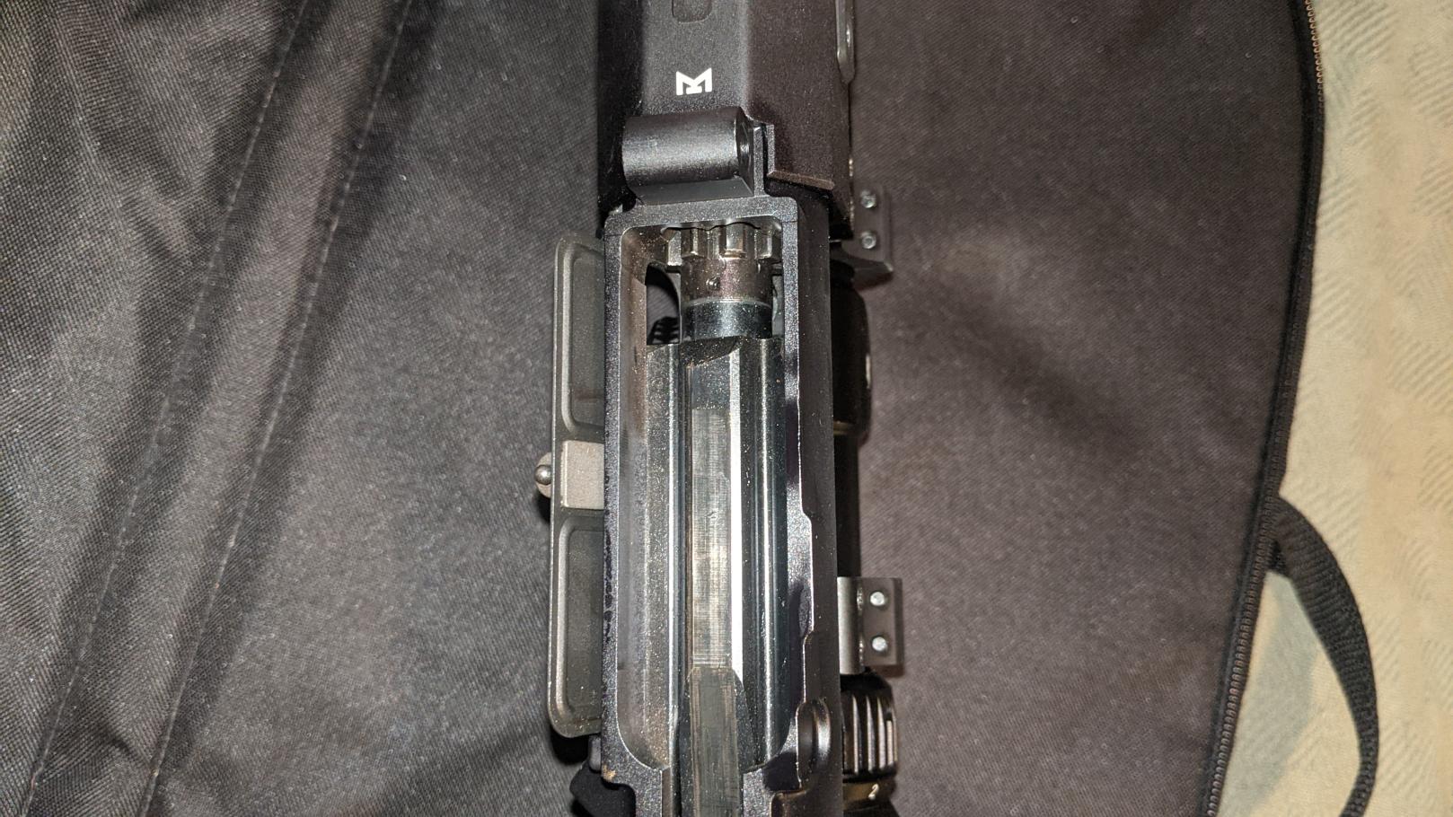

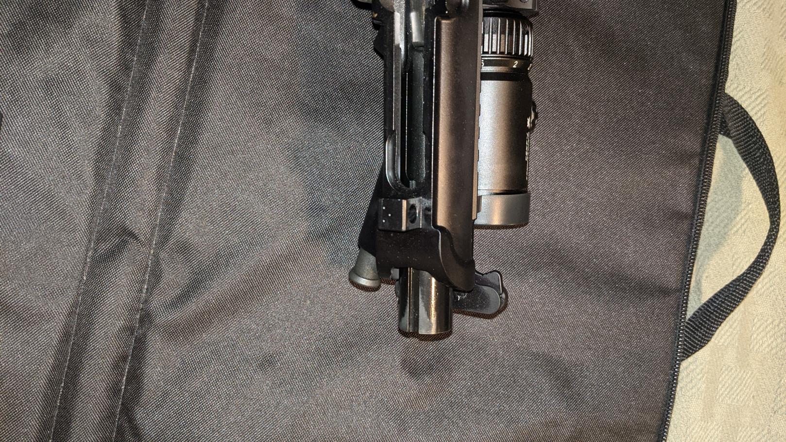

And yet another issue with my .308 - I'm getting beyond fed up
Blown primer, not a good sign for the ammo mfr. That's why I like gov't contract surplus ammo . Crimped and sealed primers. Less likely to have a blow-out that way.
That was definitely from the Herters round. Looks like i'm gonna dump the 70 or so rds of Herters I have left.
My buddy has a Galil that eats everything, wonder if he'll want it lol.
Maybe try knocking it back in to battery and try to pull back. Bet a penny there's another primer floating around in there that might just fall out.
I tried, it won't budge.
Yeah, looking at those pics, SA customer service needs to get in on this. The bottom rear of the bolt carrier shouldn't be polished up like that. That looks like misalignment between upper and lower. Even if the rear lug were hammered out and the snuggy screw were tightened up way too much, the visible wear would be on top of the carrier. Good luck.
Maybe a gas key adjustment? If it's not kicking the round out consistently. I had that issue with one of my AR15s a couple of years ago. I had a low profile gas block installed but it wasn't adjusted correctly and there wasn't enough gas to blow back and kick the round out completely. I took it back to where I bought the gas block, they adjusted it and it's worked fine ever since.
Could also be a headspace issue...excessive headspace causes blown primers.
Has it blown primers before?
First time it's happened. I'm thinking it was the ammo more than the gun.
But it definitely feels tight in there with different types of ammo.
On a side note a local gunsmith got the spent casing out for me for $20, so its ready to go back to SA, just waiting for them to email me back.
Did you see any signs indicating why it stuck?
Not Really. No damage or marks on the BCG or the chamber. Asked the gunsmith and he said it looks fine, maybe a little tight in there and to put a little extra lube in there everytime I clean/lube it.
I am wondering what SA is going to say. Think i'm gonna take it out of commission until I can have them look at it.
