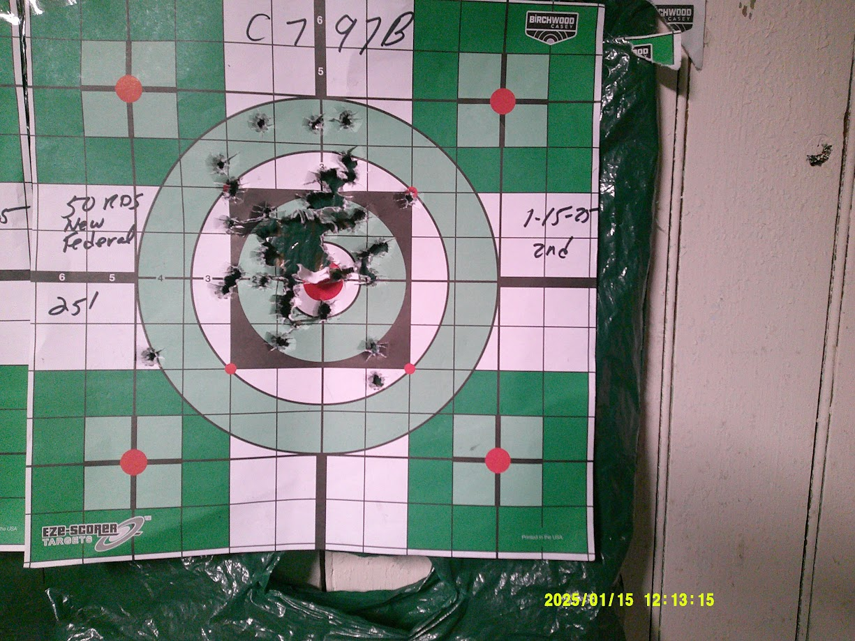

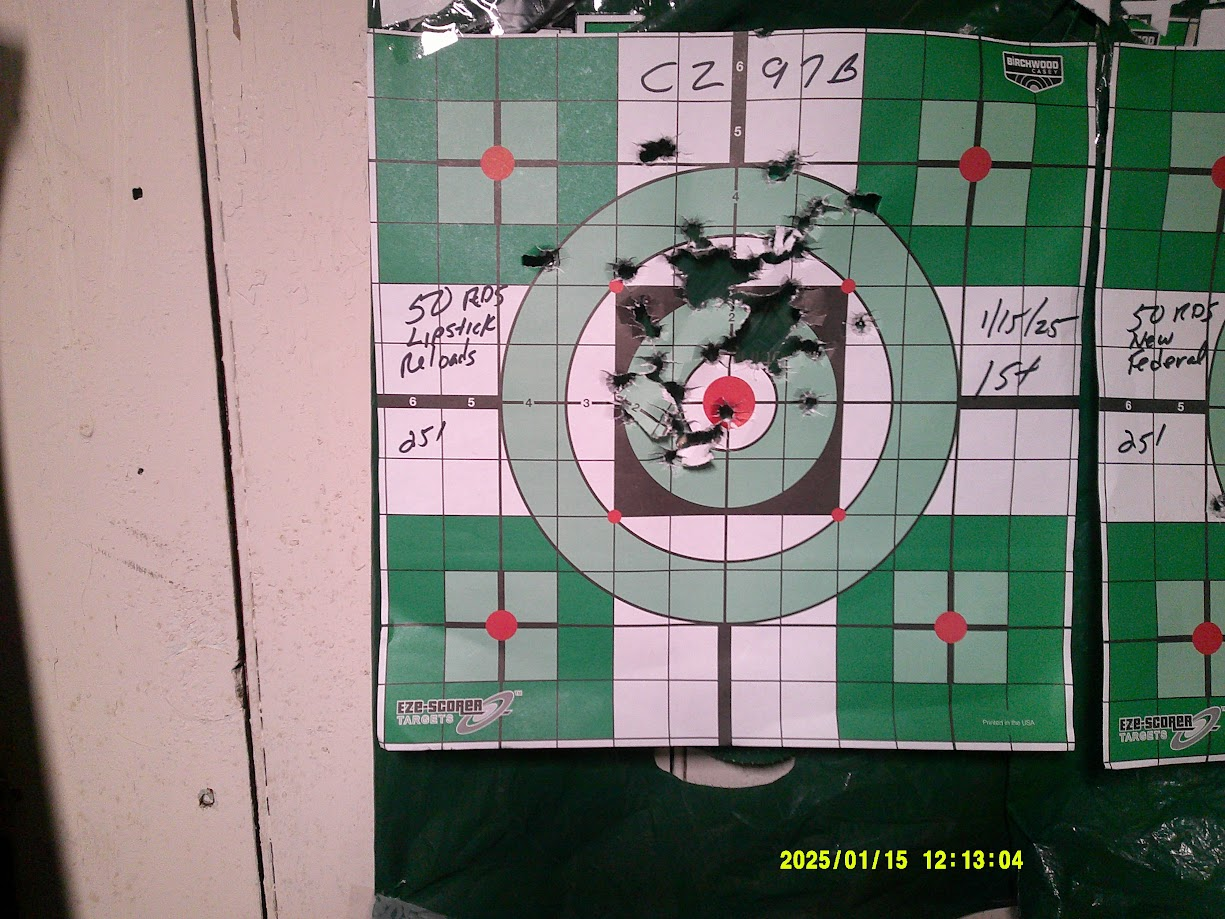

ok, GREAT day today at the club's range....took the CZ 97 B again, 50 rounds of Federal ammo, and 50 rounds of my reloaded "lipstick" ammo.
i also ran all the reloaded "lead" ammo (about 250 rounds worth, the last of the lead) thru the Dillon's tapper crimp, and yes, quite a few did indeed get "recrimped"
i should point out to, back then, i was using a Lee crimping die, for a while now, i have had a Dillon crimping die, which is buttery smooth compared to the Lee's.
1st target.
2nd
Hi,
1st target.
2nd

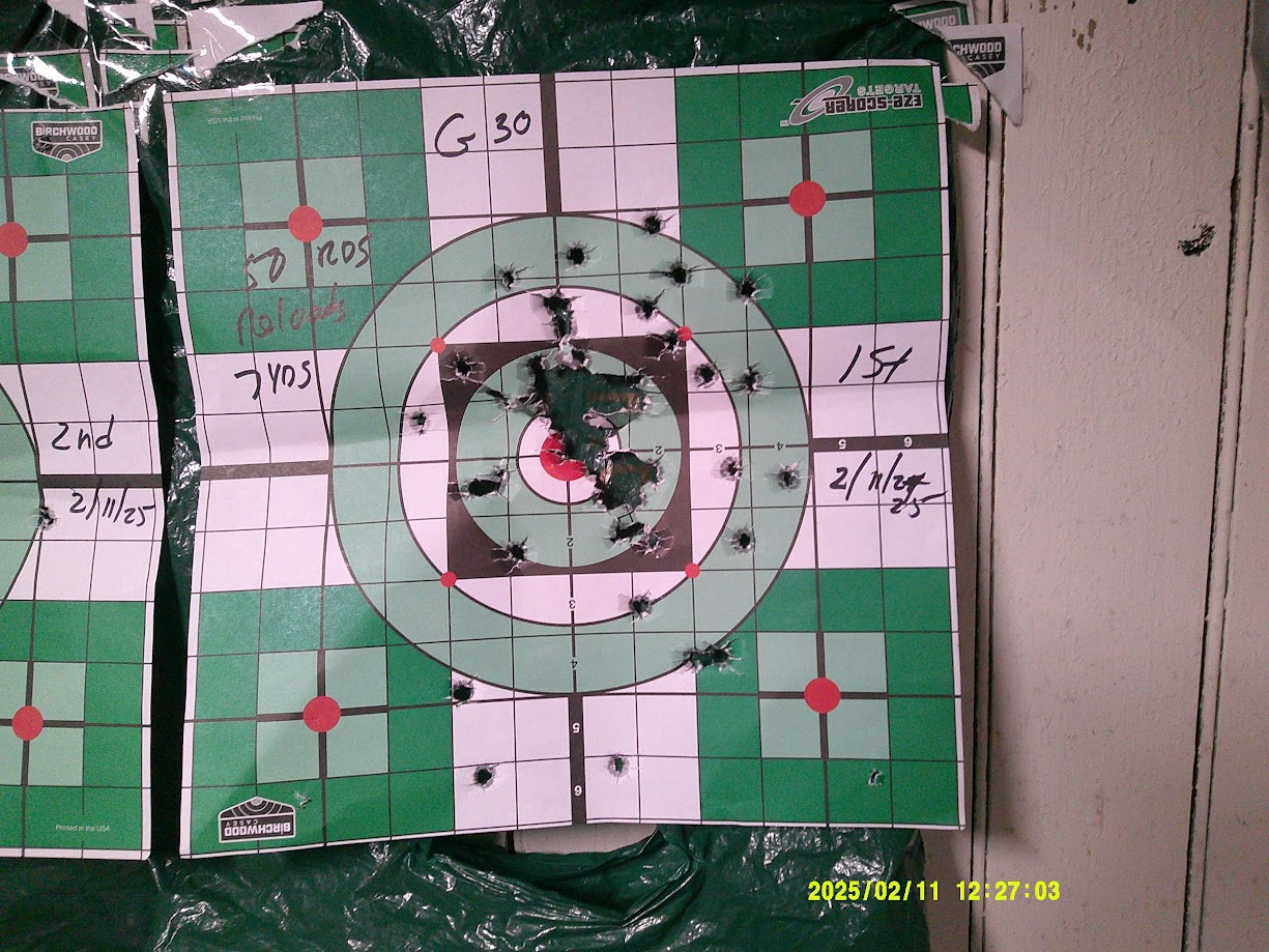

took my Glock G-30 and 100 rounds of my lead reloaded ammo, the final of the lead reloaded ammo.
targets were set at 7 yards, my "usual" practice distance.
1st
2nd
