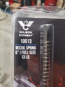

I'd be curious which one you ordered. I received a #13 recoil spring (link) from WC a few days ago, and couldn't get it on the rod at all. It clearly had a tighter inner diameter than the stock spring on my Prodigy.
The pn is 10G13. The spring in the package is the stock spring from my Prodigy.

Yeah had no issues installing it. If there is something specific that you would like checked I can take it back apart to supply pictures and part numbers if needed.
Are you talking about a flat wire spring?
Sorry, jumped the gun, just saw your picture. I believe the flat wire spring does not fit. Yours is fine.
