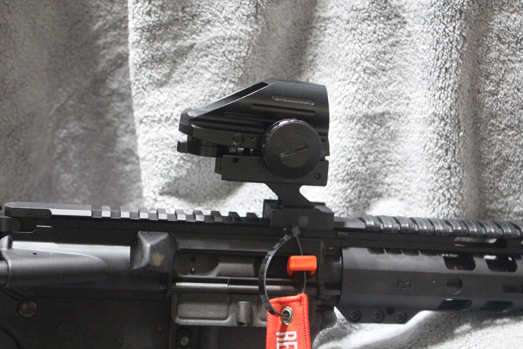

The sight I have like yours I had problems with accuracy primarily because the mount was too low, I added a thicker mounting point and the problem went away. The sight from AT3 would be easier to sight than the one you have now because of the taller mount. The AT3 sight with the .83 mount allow perfect co-witness with iron sights.
Mine is mounted on a 1.25" riser. Keeps the eyeglasses from whacking the gun. See below......

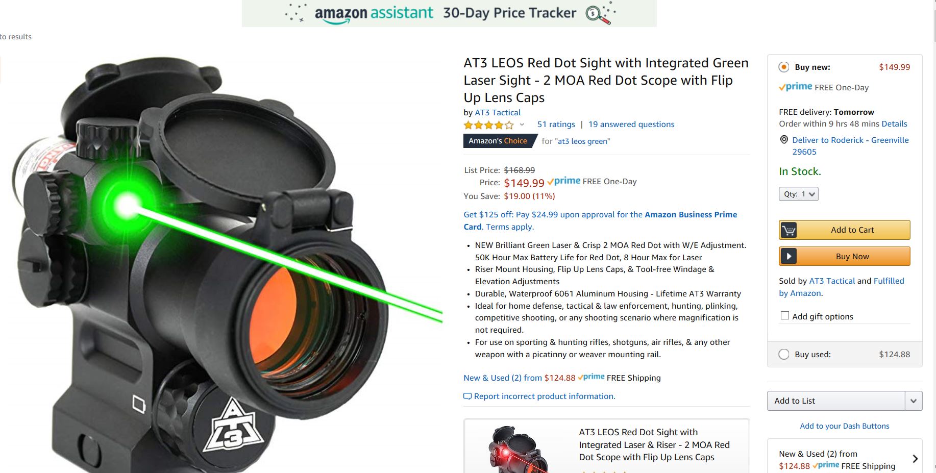

So how about this AT3? Has laser also..... that would make for quick acquisition of targets for a room to room and could have the dot for a bit further out.
What do you think?
From looking at the photo obviously your mount is high enough. At the distance your shooting the bullet trajectory should very flat. I would still with cheek placement before I replaced the sight.
AT3 comes in several models. The sight I purchased doesn't have the laser but I know it's available, I'm sure it would work well for home defense.

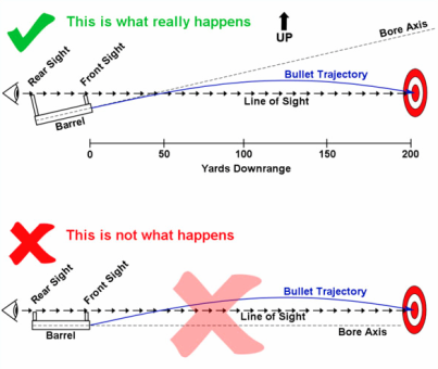

That bullet never "rises" as it comes out of the barrel: that's a physical impossibility - rather, it's the fact that you've essentially tilted the barrel up and you are intersecting bore axis with that of the sight plane, that causes the "rise" in the bullet between the muzzle and the near zero -
