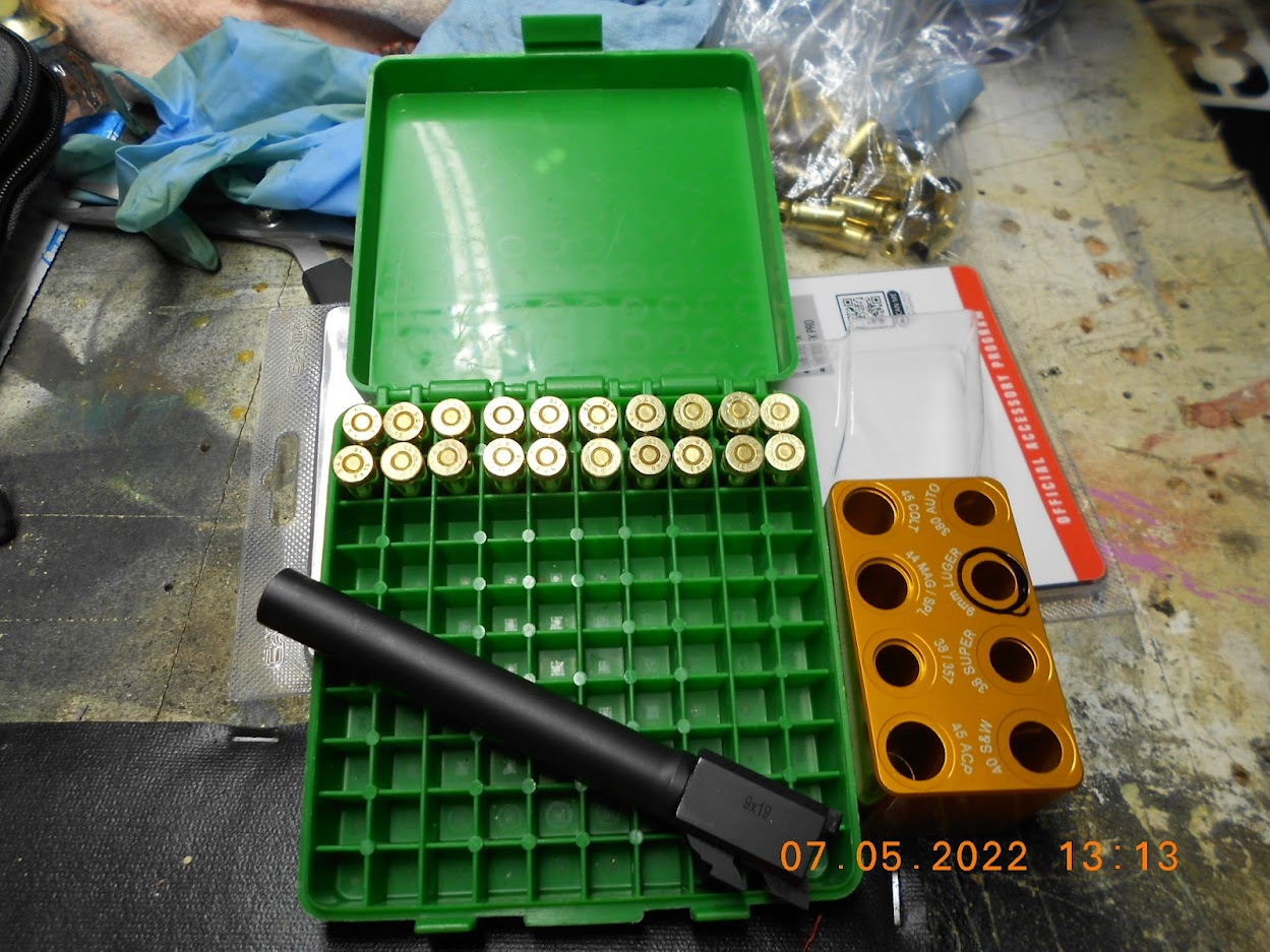

been busy with some stuff at the house past few days, so i ain't touched the Dillon for final adjustments.
i picked up those 230 gr RN cast bullets this morning. the old man at the store had to put a bevel on them and lube them a bit. no price on them, the salesman told me not to sweat that.
i been going there for a while now, buying guns, and ammo, and supplying them with apple turnovers and doggie treats....ain't like i'm a stranger...lol
i needed to set up the Lee. i hadn't really done anything to it since, well, i mounted it onto the bench..
i had dialed in nearly all the dies, except the powder drop. the plunk test went very well, i tried the dummy rounds in my RIA 1911, each one loaded great, and ejected great as well.

Dies are designed to return brass to factory specs, seat primers, dump a prescribed amount of powder, flare the case mouth, seat bullets and apply a crimp that locks the bullet in place. A finished round after processing should easily drop into a chamber. Most guns function properly when ammunition is within specs, although any may have preferences for what they reliably feed and/or accurately shoot.
I have used Dillon locking rings on Lee dies.
Don't worry about slight variations of OAL, a few thousandths shouldn't matter. Do they chamber? Can you twist the bullet? Do they chamber off of the case mouth?
1) Do they chamber?
yes
2) Can you twist the bullet?
yes
3) Do they chamber off of the case mouth?
not sure what this means, since they are crimped
Revolver brass have a head that stops the loaded round from going deeper into the chamber. Semi-auto rounds headspace off of the case mouth. There is a ridge in the chamber that this case mouth needs to stop on.
If you can twist the bullet after crimping, you need to crank down more crimp. If you go way over the top on the crimp, the chamber will not be able to stop the case at the mouth because you crimped the mouth smaller than this ledge.

so i continue to turn in that screw, all this, going counter-clockwise, to slow it down, you Dillon guys know what i mean.
FINALLY, NOTHING drops out of the funnel.......(i only filled the container of gun powder about 1/4)
now, i SLOWLY open up the funnel, and the powder comes out, SLOWLY....
but something is STILL wrong..>!!!!!!
i zeroed in the Hornady digital scale.....perfecto...!!!!
but i'm still getting powder up to the top of the shell casing....!!
like WTF....??
oh.........
i had it set to grams.........NOT grains........dumbass..........
finally, i get the 3.4 GRAINS of powder that is required for starters reloading....
load up the primer pick up tube...PERFECTO......except......PLING, DING, WHOOSH, goes the hairpin clip that holds the primers in the tube...!!
but wait...I HEAR IT, hit the wall, and i know where it fell........but i couldn't find it.......
will this day ever produce any reloads..???
so i had an extra hairpin clip...thank god for spare parts...eh..??
dump the primers, only 20 of them, into the tube.
put the first shell casing into the Dillon....
pop out the old primer, turn the shell casing to the powder drop, dropped powder....
and dropped, and dropped.....LIKE WTF NOW..???
dumbass...i didn't remember to even seat the new primer......JESUS H. CHRIST..>!!!
then the next shell casing......i put that one in sorta cockeyed....it jammed the press.
i had to use vice grips to yank it out....
like for the love of God, and all that's holy..........
the next 18 went off with out a hitch...
measured EACH one, plunked EACH one in the gauge block, and then the Canik barrel.
nearly all of them "rotate" in the barrel, i had to constantly wipe off some of the wax(?) from the lead cast bullets.
but they all plunk...!!!!!
i only did 20 for today, and remember, i said i started after 9 AM..??
1:30 PM, i finished 20 rounds....
like god forbid i should have reloaded a whole 50 rounds.....it would have been Wednesday before i finished...
but, i did have laundry in the machines, i had to take at least 3 bathroom breaks (old man stuff), and my Canik magazines arrives, so i had to check them out as well.........
my "plan" today was to do 20 9mm on the Dillon, and 8 .45ACP on the Lee.........
but as 1 PM was nearing, my eyes where closing......1PM is not Miller time, but NAP time for me......
all in all, i will over come the reloading trials and tribulations.
oh yeah, that hairpin retainer for the primer collector tube..??
I found it...!!
landed in the concrete mixing pan, right behind me.....
some days, you win ONE......!!!
i'll have measurements for another posting.........i was too tired to go back down to the basement.
