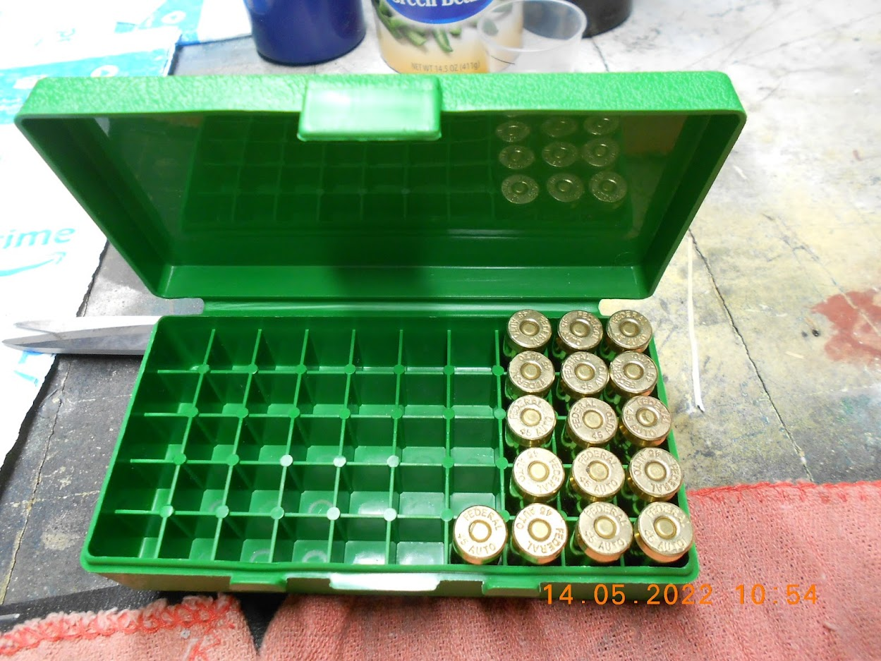

ok, today was the day i wanted to start to dial in the Lee Pro-4000 for 45 ACP.
i only reloaded 16 small pistol primer Federal shell casings. (just enough for 2 mags, for my Tisas 1911)
round nose, cast lead bullets, the bait/tackle store owner gave me 100 of them, no charge, (i mentioned that in a previous posting)
got the specs from the Lyman book.
specs for starter reloads was 3.0 gr of powder,
1.265 OAL
i still need to pull the press handle consistently, even on the Lee, like i still need to do, on the Dillon.
some quick observations is that the Lee primer system, will drop a primer on the floor, every once in a while. i may forgo that system, and put primers in one by one, by hand.
in fact, "Gavin" the reloading guy on, "Gavintoob", a you tube channel, had set up the Lee Pro as well, and he hand fed the primers.
anyway, my OAL measurements were from 1.209 to 1.250
each round, "plunked" into the Lyman gauge block, and each round plunked into the Tisas barrel, and spun in the barrel as well.
the low end of the 1.209 bothers me, but if it shoots, great, i'll be happy.
