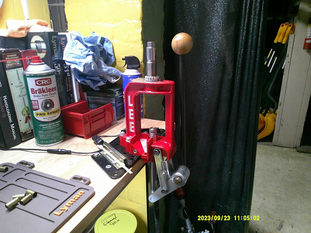

well JJ, i had already done a "few" using the shell holder and i had no issues..i could see the shell holder "slide" with in the hammer's cap.
i had 2 optional thoughts,
1) i could make the hole bigger to avoid that
2) just buy yet another tool for that new Lee "O" press i got...!!!!!! (that i use for swaging)
option 2 was best, and maybe over all....safer.
Hornady has already shipped out those "free" replacement collets.
i'd rather have a "back up plan", than no plan at all,

i have been doing quite well frankly, but that gunk i had to clean out of the Lee press/Lee seating die, mucked things up a bit.
funny how the Dillon seating die, which is also a Lee, is pristine and i do much, much more on the DIllon, than do on the Lee..!!!
