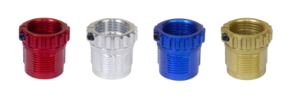

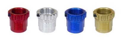

in order to use dies, of the same size, in some of thier presses, you need a "bushing" that fits into the press, for quick removal, with out messing the adjustments.
my Lee single stage has that bushing, that the Forster fits into.
however, there is a "pop up button" that prevents the bushing from coming loose.. the Forster hex nut (locking nut), jams that pop up button, and therefore allows that bushing to rotate, making it impossible to lock the Forster die solid to the press
so now, (if you refer to my pictures), i am getting a set of colored bushings. i will replace the original bushing, as it ride flat to the press, that my hope is to then finally lock that Forster die down solid.

No, Lee single stage presses are not temperamental to anything. How they are different is that Lee has perfected a 'quick change' bushing system (very similar to Harnady's) for all single stage presses to make the changing of dies, especially a convenience for batch loaders, exceptionally quick and convenient. All the presses come with one 'quick change' bushing but more can be purchased for little money.
But to answer the question, with the bushing any/all (except BMG 50 cal) dies can be used. The thread size is 7/8 x 14 iirc which is what the inside threads in the bushings are. So dies and other assorted tools from almost any manufacturer can be used as with any other brand of presses. In some few cases it may require a slight modification to use certain tools with the bushings.

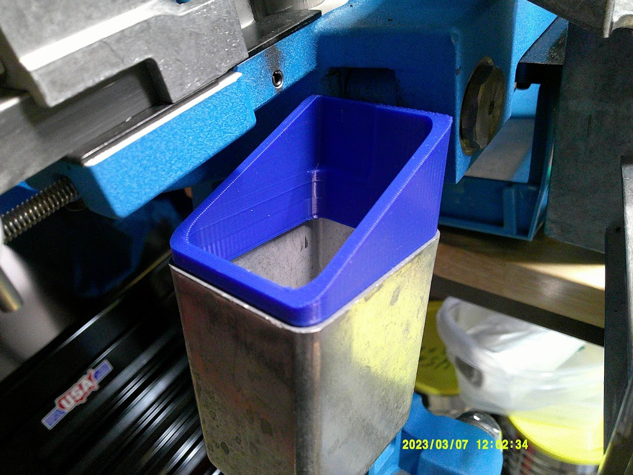

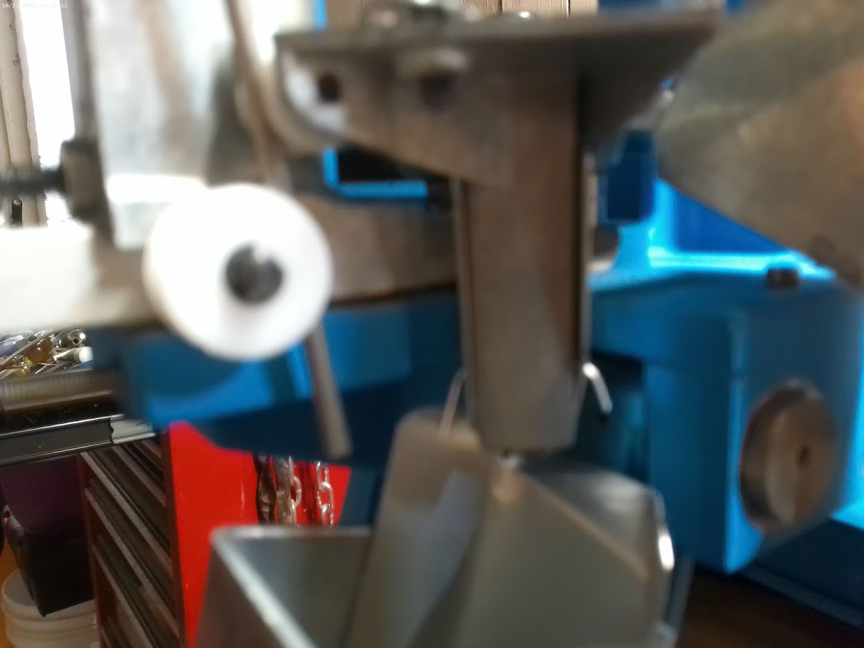

spent primers were falling on the floor from the DIllon.
i had to remove the stupid cotter pin they use for the "catch trap", with a paper clip..then i bought a neat device3D printed that directs the spent primers in to the catch bin.
an out of focused picture, of the ultra deluxe paper clip, that worked better than the EL Cheapo cotter pin...which the paper clip, allows free'er movement of the catch trap.
