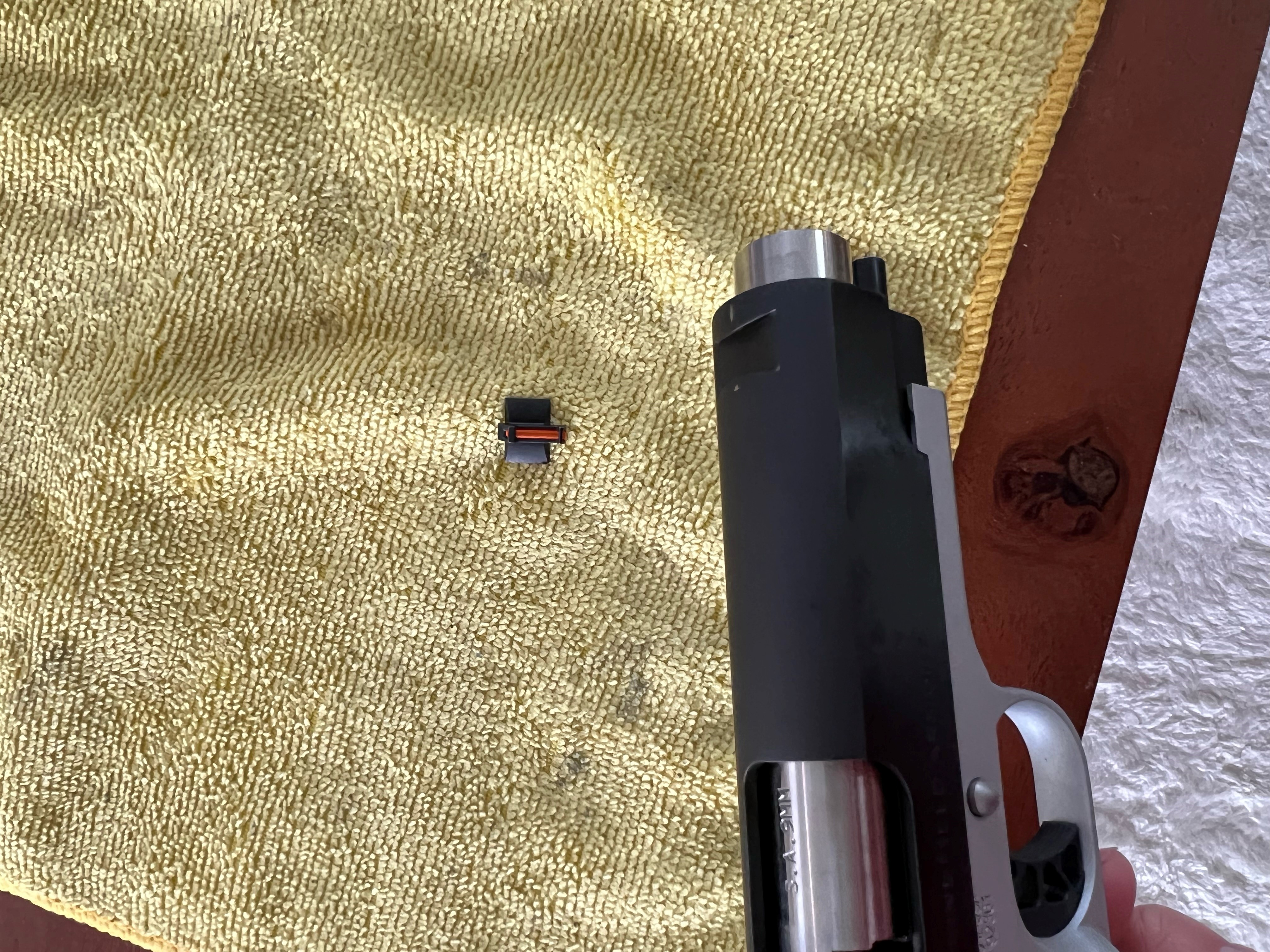

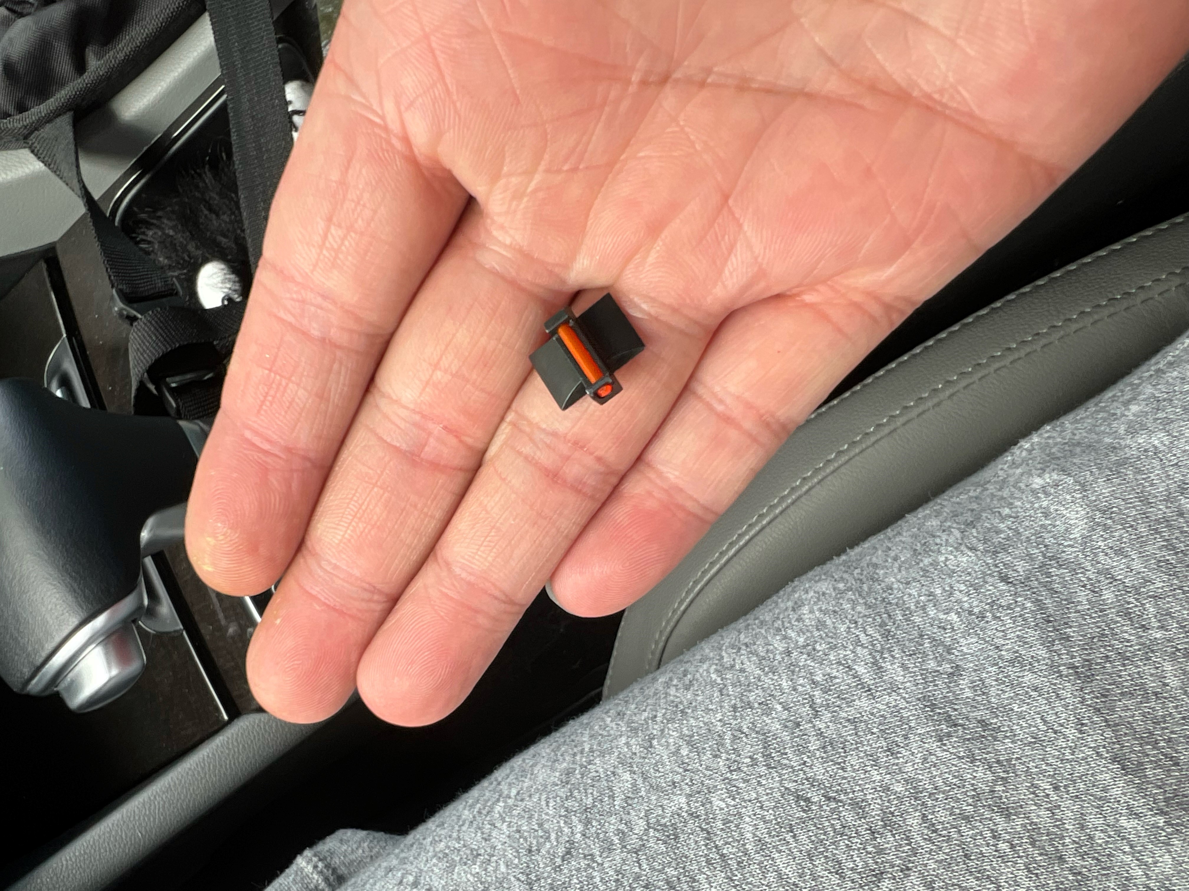

Update: Well, things appeared to be good until it wasn't. My new mags came in last week and I tested the EMP again. I had only one failure to feed with the new mag out of 100 rounds. So, I think it was a mag issue. But, today I went to the range and the tritium sights fell off my gun after 150 rounds... I'm sending the gun back to SA.
Hate to say this, but with all these issues with this gun, it reminds me of when Colt went on strike back in 1986 and they brought out office staff to manufacture guns, all those strike guns that were produced had major issues
Update: Well, things appeared to be good until it wasn't. My new mags came in last week and I tested the EMP again. I had only one failure to feed with the new mag out of 100 rounds. So, I think it was a mag issue. But, today I went to the range and the tritium sights fell off my gun after 150 rounds... I'm sending the gun back to SA. View attachment 26966View attachment 26967
Same happened to me….sights fell out on 2nd mag……but funny thing, was shooting betted without sights.
