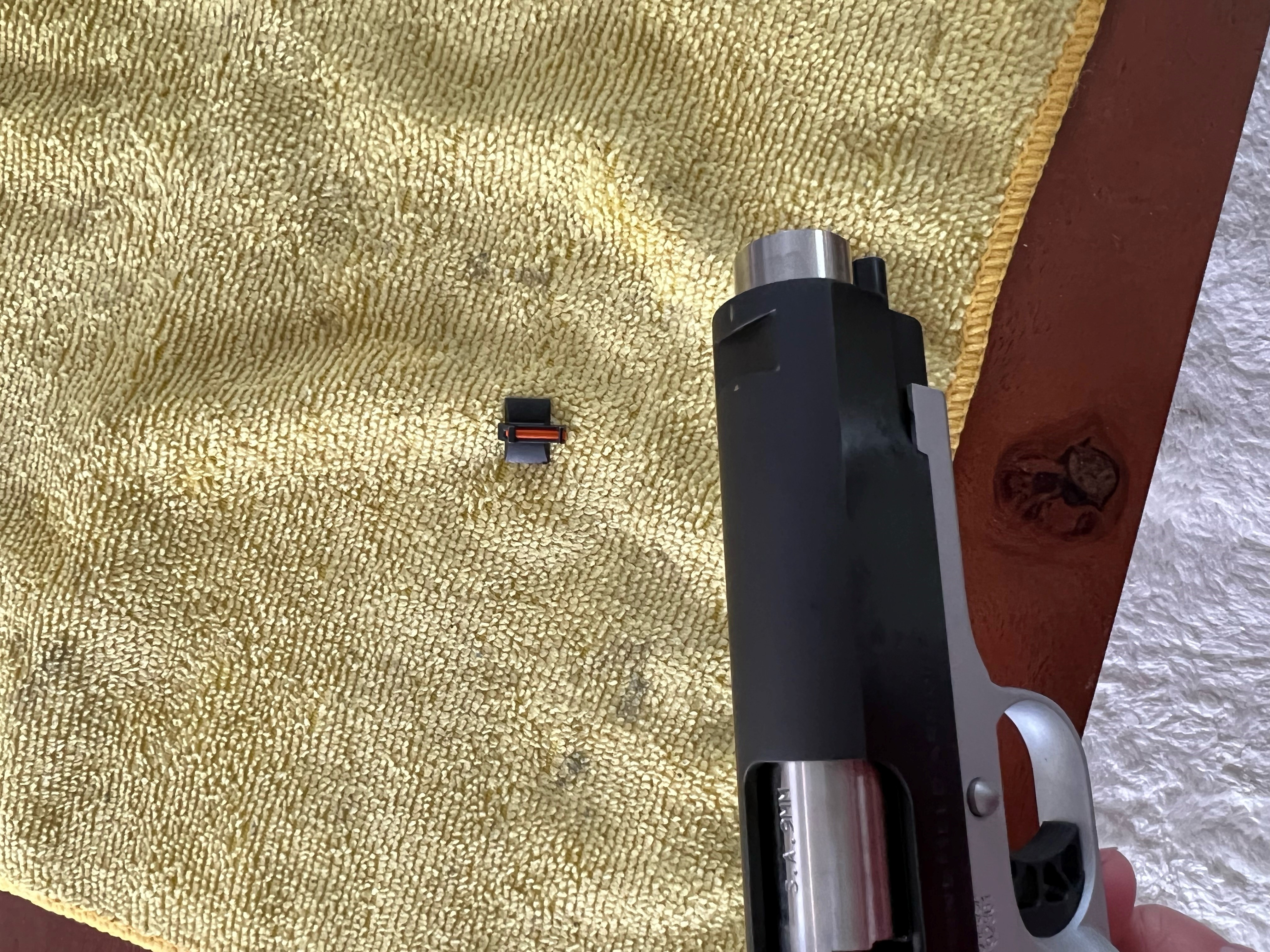

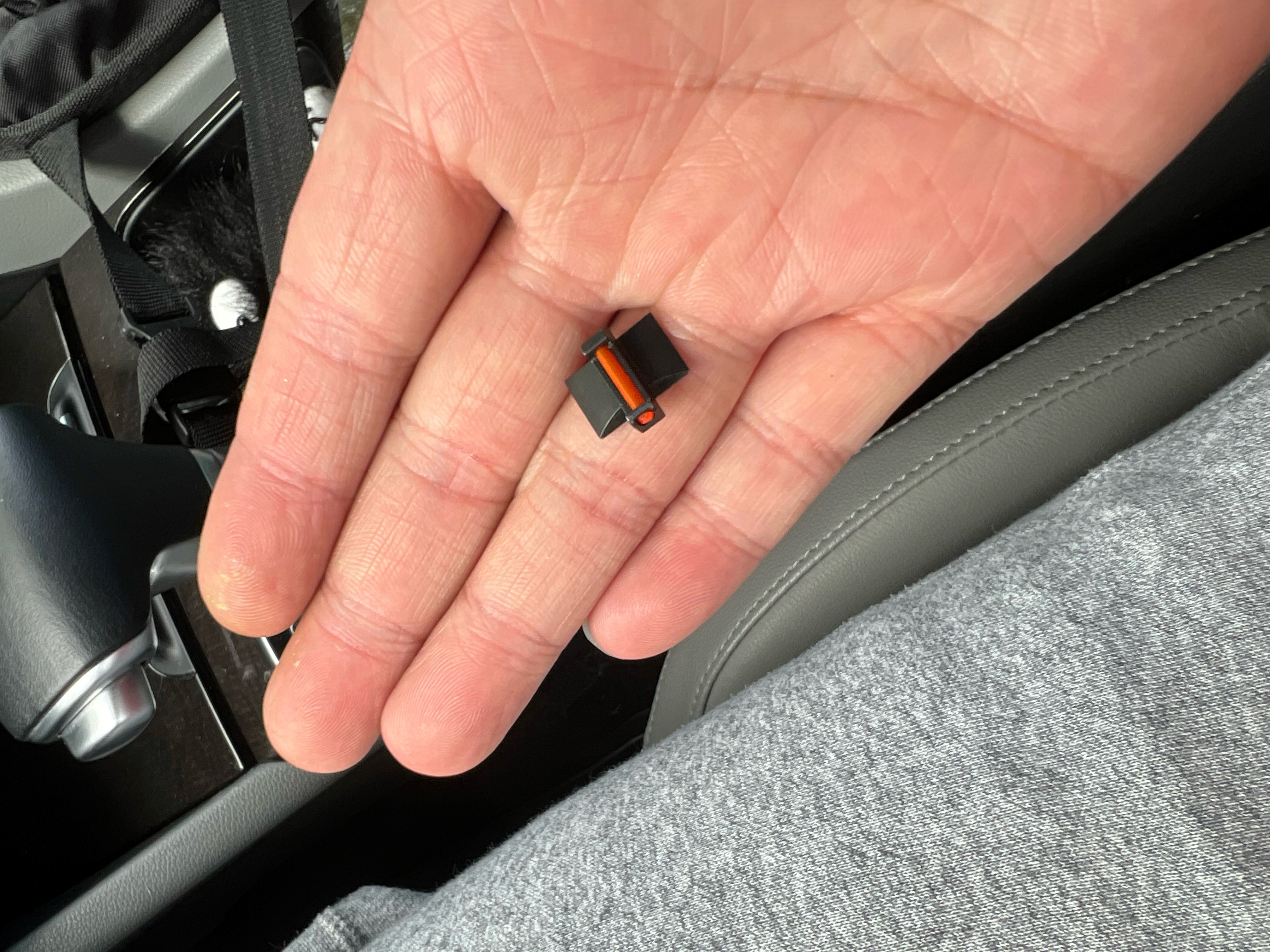

Update: Well, things appeared to be good until it wasn't. My new mags came in last week and I tested the EMP again. I had only one failure to feed with the new mag out of 100 rounds. So, I think it was a mag issue. But, today I went to the range and the tritium sights fell off my gun after 150 rounds... I'm sending the gun back to SA. View attachment 26966View attachment 26967
After I got back from the range yesterday I noticed the sight tube was missing. Little things like this annoy the hell out of me! Going to shop around and see if there are night sights available for this pistol out there.

I have a RONIN EMP 4”………does anyone know the diameter of the front fiber optic rod and also where it can be purchased ? Want to keep some in range bag.
No response from SA.
Sure you've long since taken care of this but for anyone else out there with the same problem... The fiber optic insert on my EMP Ronin fell out at the range and I couldn't find it. I was having a problem finding out what the diameter was so I could purchase a replacement. I still don't know. lol But I called Springfield and asked them and the young lady I spoke with sent me two replacements, one red and one yellow/green each 2 inches long at no cost. That problem solved. Now I just have to work on the constant stovepipes!
