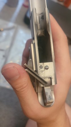

My first 1911 ever bought, man do I hate it. Had major feed issues so I sent it back to them and they "replaced the extractor, reamed, and polished the chamber, recut and polished the barrel ramp, and refit the barrel." Got it back after like 2-3 weeks, went to the range and shot 200-300 rounds and then one of the extractor legs broke so it swings around. Also it would auto rack a bullet when I smacked a mag in with slide lock active.

Unfortunately, it's going to need to go back to Springfield. Sorry you're having problems. The feed issues often go away with a lot of empty hand racking. 1911's are notorious for feed issues unless it's a high dollar custom. If it still has feed problems after you get it back for the extractor, rack rack rack. It will get better.
Why did you feel the need to "smack" a magazine into the pistol. Not sure I have ever smacked a magazine in even speed reloading.
Depending how hard the "smack",was it could have tripped the slide release.

Not to nitpick, but I’m thinking u meant the ejector leg broke, not the extractor (?)
( or have I got it back’ards again? 🤔 )
