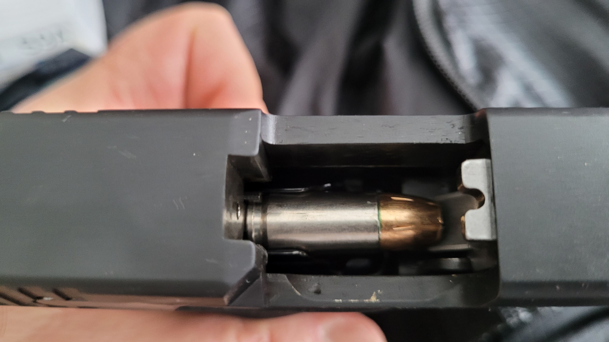

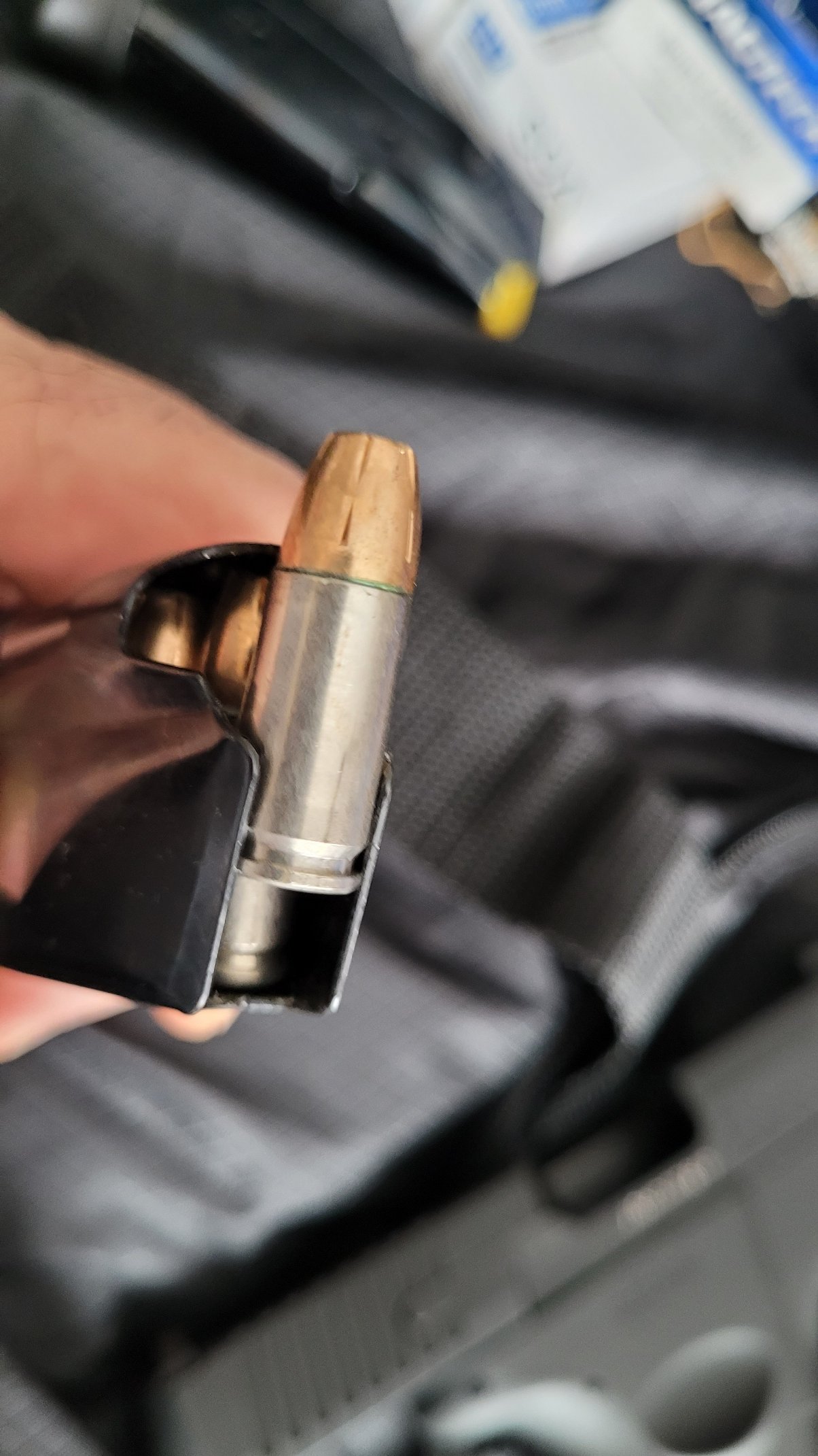

Hi, new tot he forum. I just bought a G3C a couple weeks ago. Took it to the range and it ate every FMJ round I fed it. I don't like to carry it with FMJ and had bought the same ammo from Federal you noted you had issues with. I too have a G2 but the G2S version. Liked it so much I bought the G3C for my EDC. But like you it fails to feed the first round of Federal HST. Hanging up on the lip of the barrel. I did discover though, if I only load it to 10 rounds it cycles them just fine. Thankfully the G2S has not shown any issue at all with the Federal HST.
Like you my gun is well cleaned and lubed. I called Taurus and the woman mentioned only using SAAMI rated ammo. I could not figure out if the Federal was or not. I am attaching some photos showing what happened. Maybe confirm you had this happen as well.
I sent Taurus an email with these same photos. I will see what they recommend to me as well. I did not change the barrel with my G2S as you did.
Keep us up to date on the issue and I will do the same.

Seems like the same issue for sure. Taurus’ resolve is to go to the range and shoot 200rds non-hp and that will wearin the feed ramp....I got some Fiocchi Hp and Hornady flex tip and only had this happen if I put in all 12 rds in the mag.

Your pics look very familiar to me...lol, a couple of posts above yours, I posted a long winded explanation of sending my handgun back to Taurus where they did everything except work on the barrel. They did some modifications to the slide, slide spring, and sent it back....and, although I'm still not sure exactly why, it's now cycling HST without issue....weird deal.
