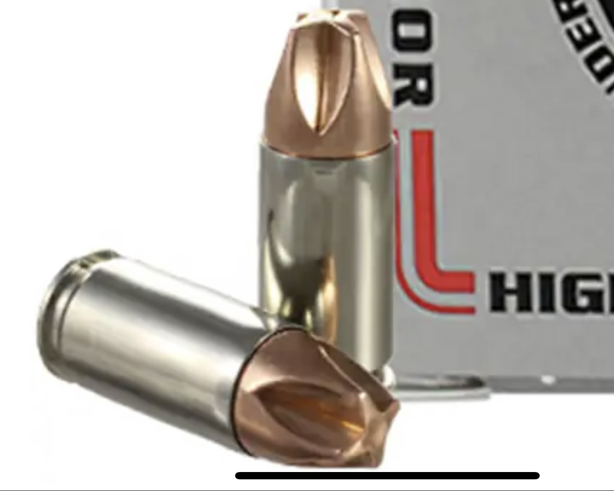

Update: I have several boxes of this 4-flange version of the bad ass ammo shown above - oh- here’s a picture of it
and it cycles without issue through the VP9 (40 round magazine flipped through effortlessly) and and also ejects forcibly and feeds without problems in the G3C as long as I fully, forcibly rack the slide with no hesitation and release completely from the hard stop. That ammo kicks out harder than ball ammo in the same situation in fact. The four flange design vs the three flange of the Black Hills HoneyBadger is a big difference in profile and performance.
If I hesitate on the rearward motion at all, it’ll hang. If not it won’t. I believe it would actually fire without issue and I’ve got 40 rounds in a 40 mag that I plan to run through the VP9 in one fell swoop.
I think it’s the human element that hangs rounds while cycling the slide if there is any hitch in the backward movement. I think. So far.
The 3 flange bullet above (HoneyBadger) gets it choked about 1/20 maybe. it cycles the 4 flange version no problem. Awesome carry ammo, both of them.
Update: the VP9 ran through 40 rounds of the Underwood four flange round nonstop today. The G3C ran through 24 with no issues, and 12 or something of ball ammo.
