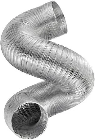

2nd,.. yes, i remove the bendable (flexible) vent hose, (it is very light weight) i take it outside and run the garden hose thru it...
then place it back onto the drier, reapply the duct tape, at the window connection, to seal it, and run the drier for like 5 minutes to....dry it out.
if i try to run a brush thru it, it could puncture a hole, then i gotta got and buy another one. (happened to me years ago)
garden hose is easier...
you have the all metal "'solid" vent hose..???
i can't, the relationship from the drier to window is convoluted for me to have a "solid" venting hose.
solid vent hose
my flex hose.
ok, my dryer is in the basement, so the window is just above, to the right, i cannot use a solid "hose/vent", i need a few slight bends.I have all metal flex hose to dryer and all metal piping venting out to the roof.

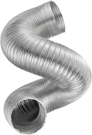

solid vent hose
my flex hose.

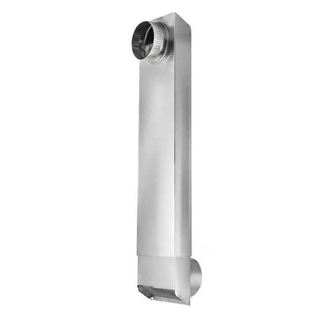

never heard of a schedule 40 loop?My dryer contains two of the flat ducts like the first picture. One coming out of the dryer and going under the floor into a 4" schedule 40 loop I built ( no glue) then back up to the floor on the other side of the room, into another flat duct and out of the house. I access the crawl space through a trap door, take the schedule 40 apart and clean everything by hand. Takes about 20 minutes.
Schedule 40 is heavy sewer/water pipe. I used 4", made a big ol' C out of it under the floor to run from an interior wall where the dryer is to the exterior wall where it vents outside. 3 straight pieces of pipe, 2 90s and 2 flat ducts.never heard of a schedule 40 loop?
