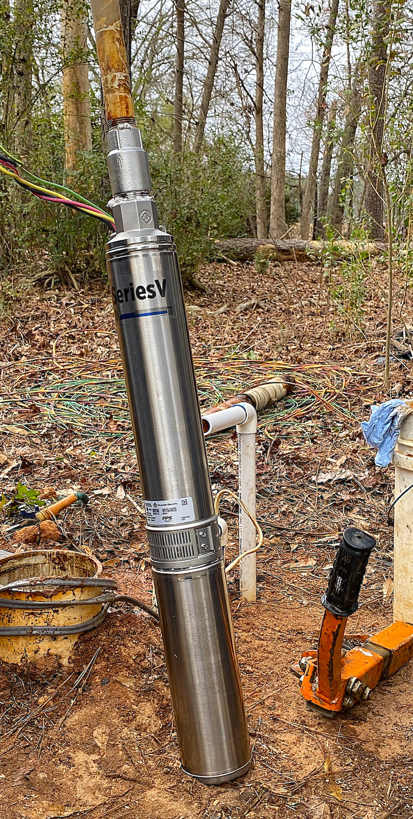

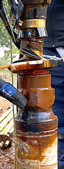

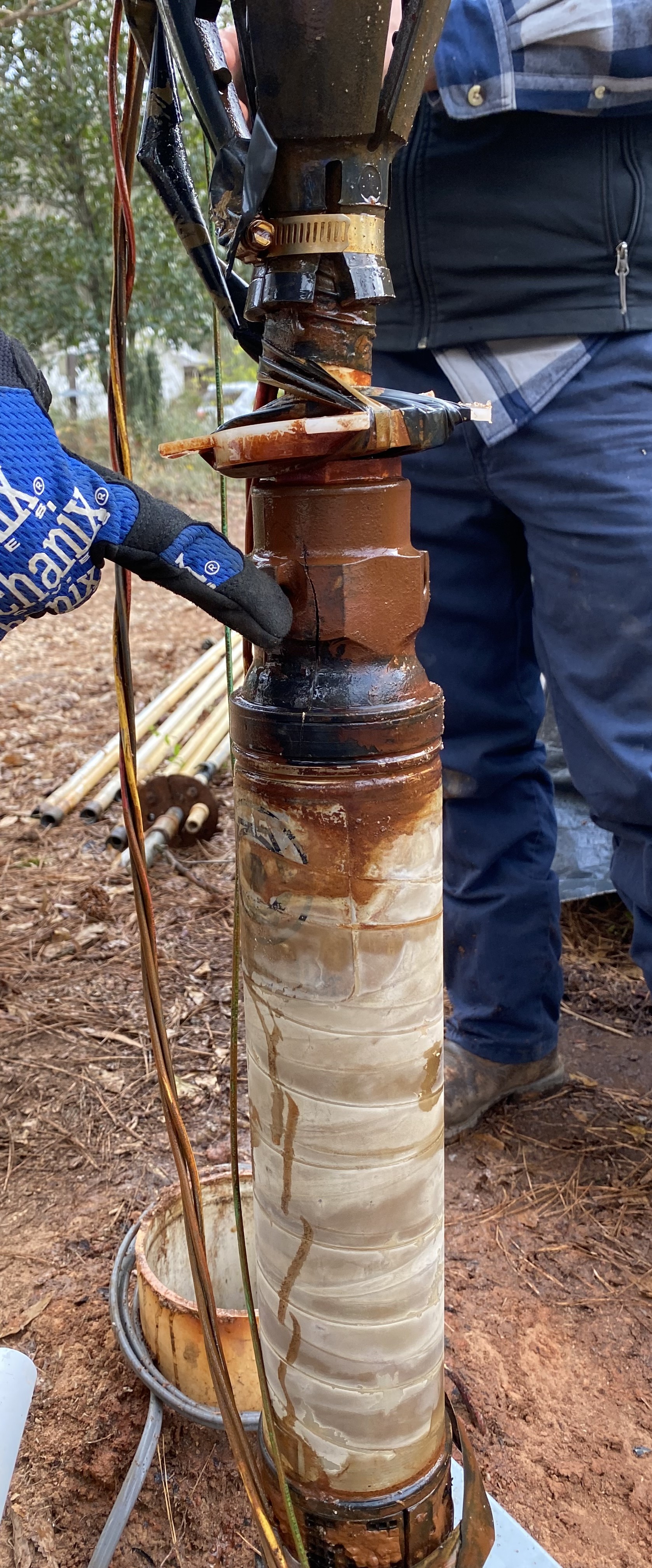

The 33 year old pump had developed a crack up where the down pipe connects, it was replaced with a Franklin Electric Series V pump.

Yeah, those cracked heads are less common today than in years past...the injection molding process has improved, as has the polymer used for the part. That cracked head will act exactly like a hole in the pipe.
I used to sell the Franklin series 5 (V) maybe 10 years ago. Good pump.
