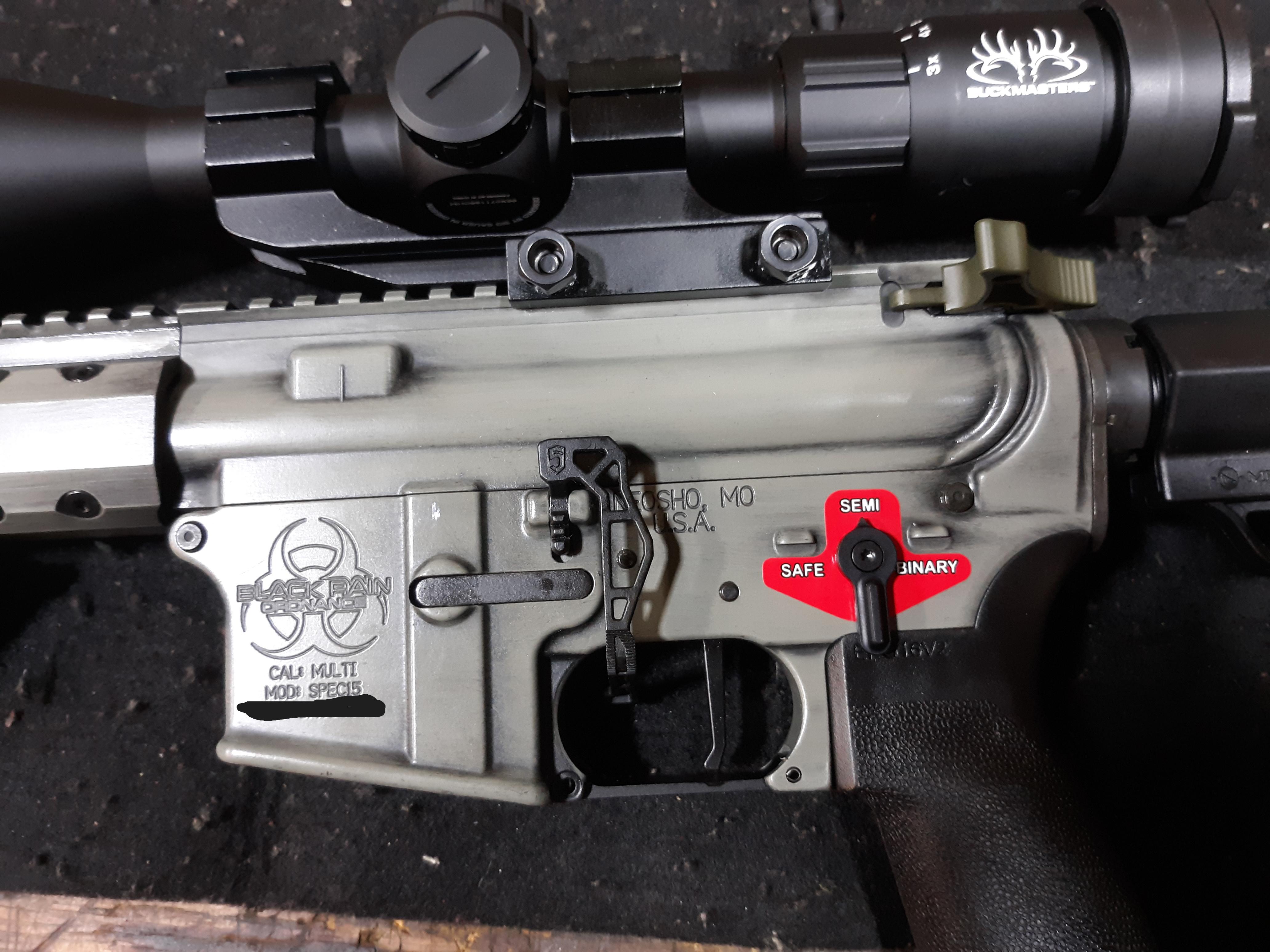

My very first binary trigger install..Piece of cake.
