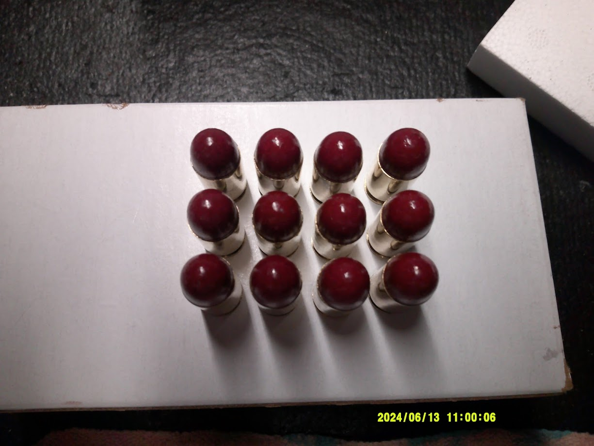

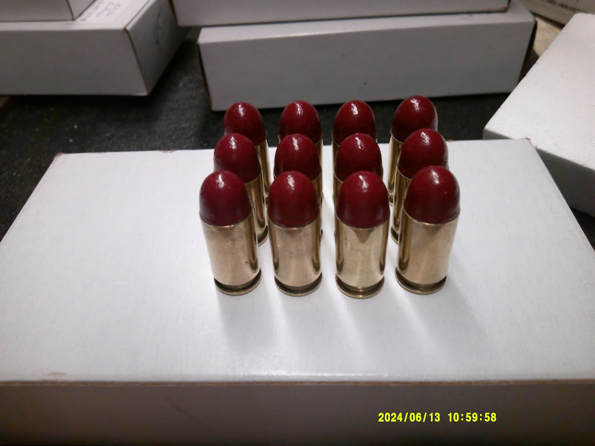

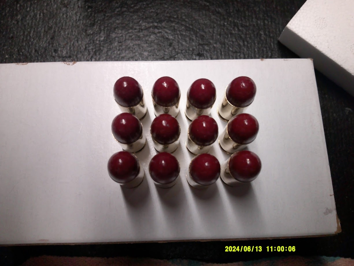

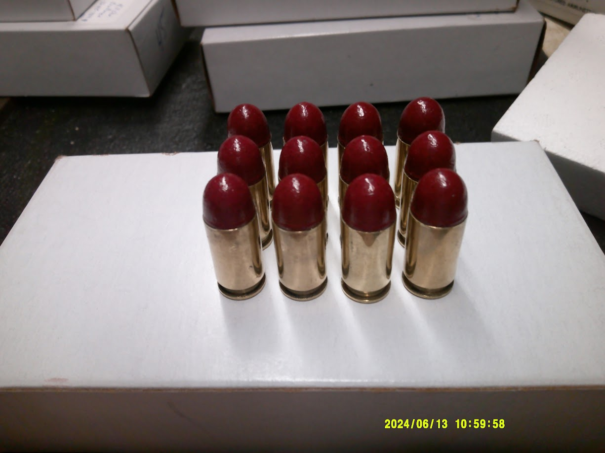

i had 13 of the coated bullets to finish my tube of primers, (from reloading the lead bullets), but i don't like 13, so i will take 12 to the club next week.
i should point out too, i checked all my books, for max powder charge, which for Titegroup, that is 5.1 grains.
so i reloaded at 5.0 grains, @ 1.272 OAL
tell you what too, after reloading with the coated bullets, it was a pleasure to not have to wipe off the wax, that the lead bullets have in the groove. Badman coated bullets had no wax in the groove. if i did not wipe the wax on those lead bullets, they will stick in the go/no go gauge.
i am "dying" to see far less smoke, since they are coated, and more better performance with the near max charge

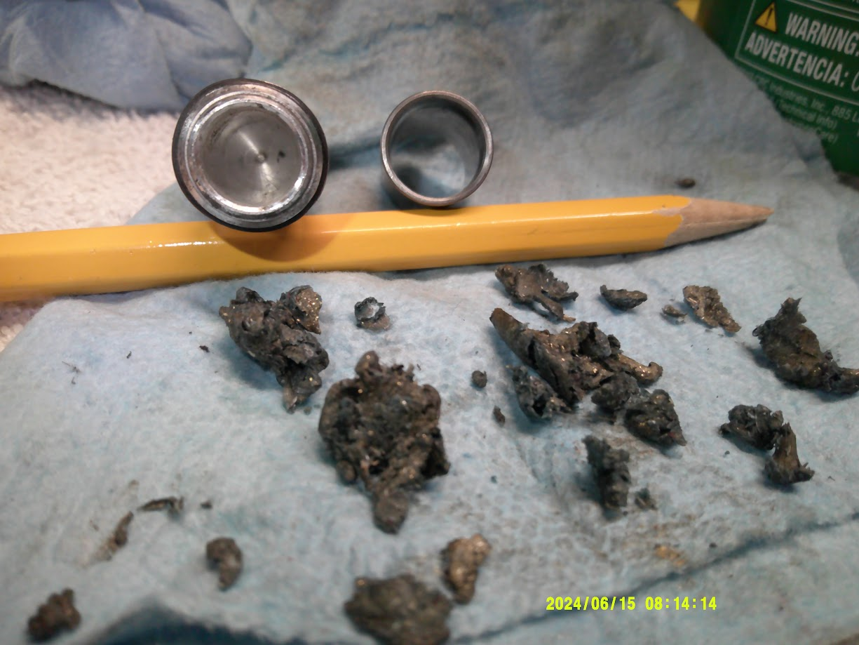

well, like i said about not being embarrassed about my targets, i will post 1 picture of my crimping die from the Dillon. the handle was taking some extra "pull" to crimp the bullets.
and i tell you what too, this seals my thoughts on staying away from lead bullets, especially with that damned wax seal in the groove.
the seating die, was actually quite clean........so "brake clean" took care of that, as well as the decapping die.
in this picture, the build up of the wax, was inside that "collar", and some was jammed into the end cap....
this is from at least 3050 rounds of reloading
i had cleaned the Lee several months ago, and hadn't done any reloading on that as of yet..(set up for 9mm)
strange too, on that press, the seating die was all gunked up, and the crimping die was good.
